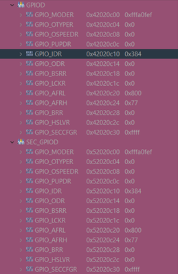

Hi, apologies again for a late response. Here is the register values for GPIO port D.
waclawek.jan
April 28, 2025
According to the STM32H562 datasheet, there is no TIM13 nor TIM14 pin at GPIOD.

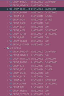

My apologies, I was looking at the port for the wrong PWM peripheral pin I was using. Here is the port values for GPIOA which should be the correct port.

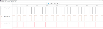

This is a test involving TIM13, TIM14 and TIM1 channel 1.
Best Regards
Younes

April 30, 2025
Hi @dlewis
I started from 0 as pulse period as you suggested, then I changed the periods for TIM13 and TIM14 as follow in accordingly in the while(1).
 MX_GPIO_Init();
 MX_TIM13_Init();
 MX_TIM14_Init();
 /* USER CODE BEGIN 2 */
 HAL_TIM_PWM_Start(&htim13, TIM_CHANNEL_1);
 HAL_TIM_PWM_Start(&htim14, TIM_CHANNEL_1);
 /* USER CODE END 2 */
 HAL_Delay(4000); /* no output signal as pulse = 0*/
 while (1)
 period1 = (period1 + 100) % 900;
 sConfigOC.Pulse = period1;
 HAL_TIM_PWM_ConfigChannel(&htim13, &sConfigOC, TIM_CHANNEL_1);
 period2 = (period2 + 200)%900;
 sConfigOC.Pulse = period2;
 HAL_TIM_PWM_ConfigChannel(&htim14, &sConfigOC, TIM_CHANNEL_1;
 HAL_Delay(3000); /* delay to follow changes*/
 } /* while 1*/
 /* USER CODE END 3 */
 I can see that the wide of the pulse is changing using a logic analyzer.
Can you add the other timers and check if there is any issues?
Best regards
