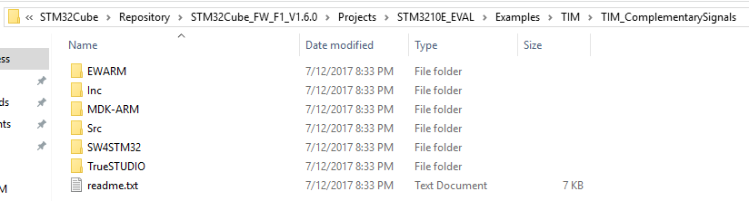

Posted on September 08, 2017 at 01:37
Hello!
Go to
http://www.st.com/content/st_com/en/products/embedded-software/mcus-embedded-software/stm32-embedded-software/stm32cube-embedded-software/stm32cubef1.html
and download the firmware.
Inside , you can find an example using the Break Feature (and OSSI  bit)
Regards
VF

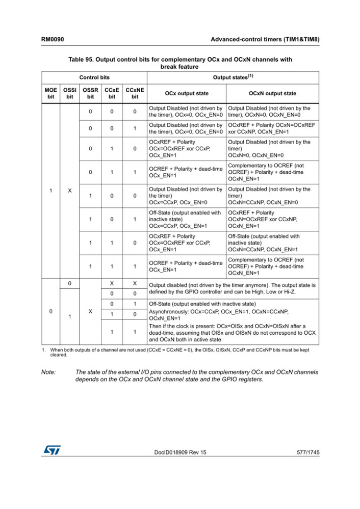

Posted on September 08, 2017 at 08:16
This table is in RM0090 for the 'F4 and its second part (MOE=0) sheds some light on the OSSI issue:
In other words, if MOE=0 (which is the consequence of break input getting active, i.e. the ''something terrible happened, bail out'' mechanism engaged) you can chose if the outputs go threestate (when OSSI=0), or driven to a given state (see narrative there).
It appears that this table is incomplete in RM0041 - would like to know if on purpose or by mistake.

Posted on September 08, 2017 at 21:53
Thank you all for helping me to solve my problem.
Vangelis Fortounas, in that example bit OSSI is set to 1:
sBreakConfig.OffStateIDLEMode = TIM_OSSI_ENABLE;
HAL_TIMEx_ConfigBreakDeadTime(&TimHandle, &sBreakConfig);
I would like to know the difference between the two modes (OSSI=0 and OSSI=1).
waclawek.jan, in my case, i could not get 'disabled state' at the output. I always get a 'idle' state, regardless of the OSSI bit (outputs OCx=OISx, OCxN=OISxN, except when simultaneously
OISx=not CCxP,
OISxN=not CCxNP).

Posted on September 12, 2017 at 22:06
As I said, I quoted from the RM0090 manual, which is for the 'F4.
As I said there, that table is not completed in RM0041, and this may be intentional.
