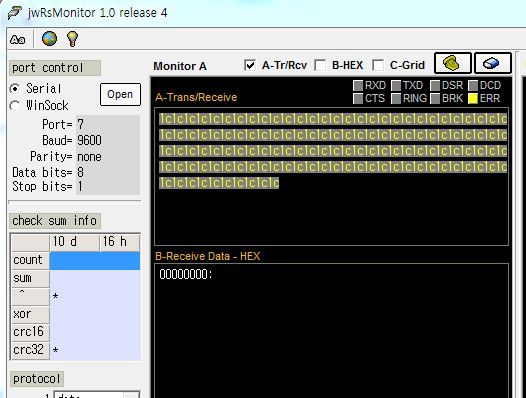

In case TEST 1 and TEST2 have the same output result as the below image.
What am I supposed to do to resolve this problem?
should I have to calculate about
USARTx->BRR

Posted on September 11, 2017 at 16:50
Can we *PLEASE* keep all your USART related adventures in one thread? Your audience here is limited.
You would need to make sure HSE_VALUE is correctly defined for the board, perhaps in stm32f4xx_conf.h and be 8000000 and not 25000000. Check also that system_stm32f4xx.c configures the PLL with the expectation of an 8 MHz crystal and not a 25 MHz one.
Unless you change the bus speeds dynamically you shouldn't need to revisit USART->BRR
Send an 0x55 data pattern and confirm the bit timing with a scope. Don't send data to the register unless TXE is asserted, you'll just garble things.

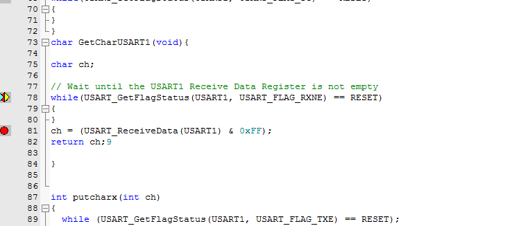

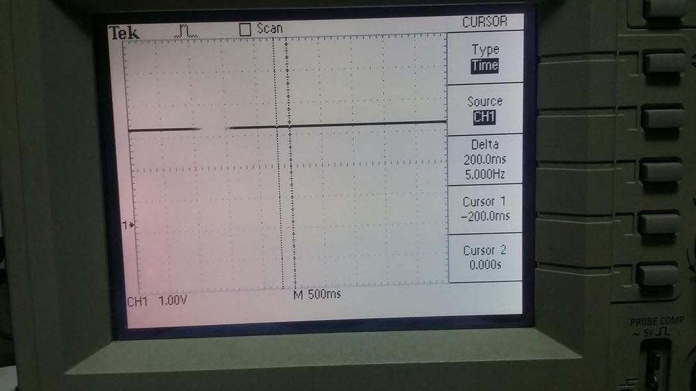

Posted on September 12, 2017 at 16:16
Clive, I'm struggling to receive data from PC with code below.
Sending data from STM32 board to PC is working good.
But receiving from PC has a problem.
The below image ,  I just prove the PA10 while sending data.
I'm not sure but would you please check this configuration?

What am I missing?
Currently, stuck in here  while(USART_GetFlagStatus(USART1, USART_FLAG_RXNE) == RESET)
during sending the data from PC to eval board.

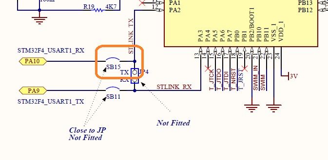

Posted on September 12, 2017 at 16:31
So you show me a static signal on the USART1_RX and ask why it receives nothing?
Is this pin clashing with the VCP? Did you disconnect the ST-LINK's USART from the STM32F429? Make sure SB15 is *REMOVED*
Posted on September 12, 2017 at 16:34
See here, where you were told about removing SB15
https://community.st.com/0D50X00009XkXNtSAN

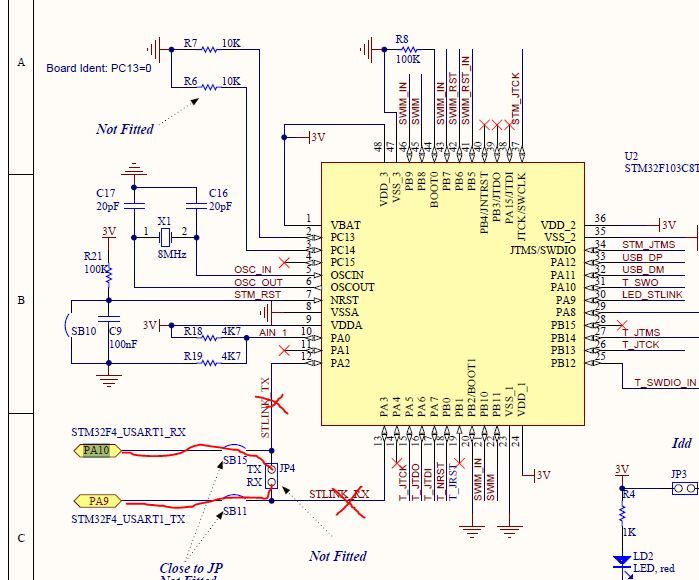

Posted on September 12, 2017 at 16:49
Can check once again please ?
I prove the each pins PA10 and PA9 to PA2 and PA3.
Then I found PA10 is connected with JP4's TX and PA9 is connected with JP4's RX not PA2 and PA3.
I can't find their connection between PA10 and PA2  also  PA9 and PA3.

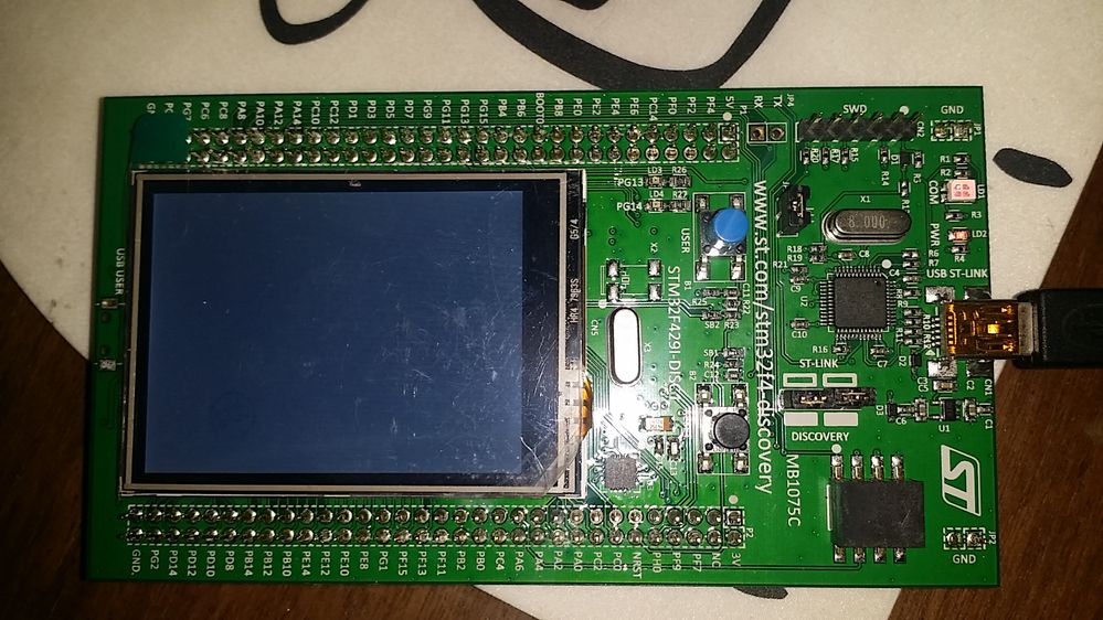

Posted on September 12, 2017 at 17:01
What am I checking? Are you using the ST-LINK's VCP for these tests, or your external serial dongle from you prior thread?
What exactly have you go wired to what?
A scope trace with a flat-line is not going to result in data reception, if you are sending data why can you not see it?
Posted on September 12, 2017 at 17:07
Isn't USART1 connected to the VCP on the DISC1 board? via PA9 and PA10.
As you said, I think I have to look for another free pins for using UART.
BTW If I remove SB15, is there any serious problem?
I think it's connecting with 'uart bootloader'.
Posted on September 12, 2017 at 17:14
No, I'm not using uart pin for uploading firmware. I just connect to mini USB cable.
As you can see the scope trace, I think something work as a barrier to prevent received data from external serial dongle
