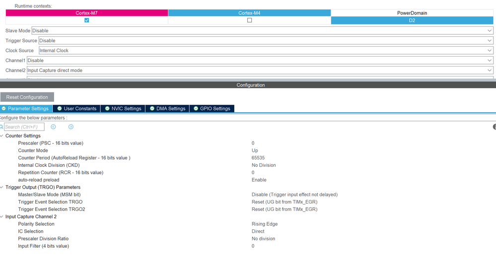

The timer used is TIM8, here's the configuration:

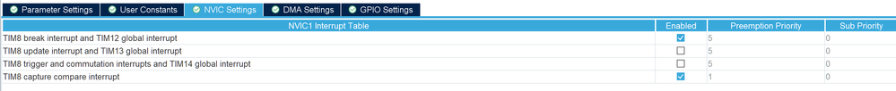

0693W00000QKlGeQAL.pngInterrupts enabled:
0693W00000QKlH3QAL.pngI have my test signal connected to the channel 2 input, and to my oscilloscope input, so I'm sure the test signal is present and valid.
I set the debugger breakpoint to the input compare callback function.
When no signal is present - it is not called what is expected.
Then I connect the test signal, the input compare callback is called.
But what I read is zero, no matter what input signal I provide. I tried various frequencies, from 32Hz to 100kHz.
CCR1 register value is always 0, and period counter (PC) is 1.
That doesn't make sense. It doesn't work. I'd expect at least PC to be 8.
The CCR1 register should contain any value but zero.
What am I doing wrong here? Where's the catch?

Oh, please delete it, or let it leave for other unlucky silly people like me...
CCR1 is for CHANNEL 1. I use CHANNEL 2. It works.
