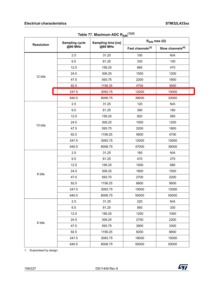

What's the impedance of the 1.026V source? Try increasing sampling time, see datasheet.

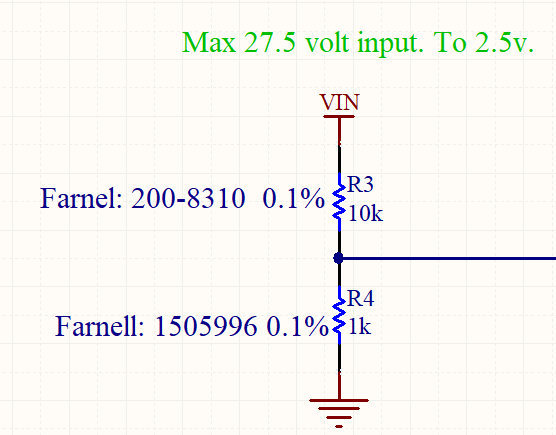

Hi
Im not great with impedance , but what I am trying to do is measure the input voltage. See below picture. The output of the divider goes right into the ADC. If I stuck it through an opamp as a buffer, would this improve it?
Cheers
Scott
‎2023-03-26 2:23 AM
The reason why input impedance matters is, that it has to fully charge the sampling capacitor during the sampling phase.
Opamp follower is never a bad idea, but if high input impedance and too short sampling time is the primary problem, it should be enough to increase the sampling time.
‎2023-03-26 2:42 AM
Hi
Thanks for the reply. As I was using the HAL (easier for testing), I set the sample rate to 247 and 640 , but still had the same result.

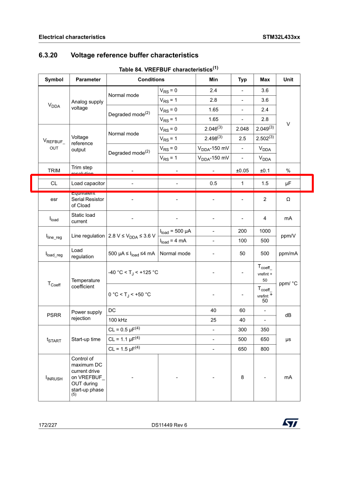

‎2023-03-26 10:20 AM
See Section 3.17 in the data sheet.
The answer comes out real close if you are on the internal 2.048V reference buffer.
A resistor divider external buffer may need the Figure 5 capacitors to provide a clean reference. A 1.0 uF will probably be OK for the mystery capacitor.
‎2023-03-26 2:44 PM
Oh, it didn't occur to me that VREF+ is not connected to an external 2.5V reference, but is fed from the internal reference instead...
In that case, the "mystery capacitor" actually needs to have a relatively precise value (actually 1.0uF as said by @raptorhal2​ in parallel with the 100nF ceramics is just OK).
‎2023-03-27 12:17 AM
Hi
Sorry, I forgot to add the below to my picture above (see below). As per manual I have 100nf and 1uf to vref. As you see I already have a 1uf added.
