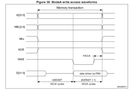

Hi community,
I'm developing on STM32F7, it accesses the external device via FMC.
Then it can read the external device's register, but it cannot write to the register.
The external device expects EXTMODE ModeA timing like the following figure.
Reference from
RM0410 Rev 4 Reference manual
STM32F76xxx and STM32F77xxx advanced Arm®-based 32-bit MCUs
Our issue is that NEx signal and NWE signal are falling down at the same time on our target board.

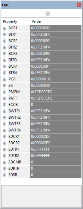

‎2019-11-27 5:22 PM
Hi JW,
The relevant FMC registers' content is as following.
BCR4 = 0x00005091
BTR4 = 0x0FF212F4
BWTR4 = 0x0FF219F4
I attach the picture of the the all FMC register's content on MDK-ARM.
This picture took after initializing on our target board.
Thanks in advance for any help.
Thanks,
Hiromichi
‎2019-11-27 10:45 PM
This appears to be OK to me.
Are you using also the remaining 3 banks, and they work OK?
Do read waveforms (especially NOE) work as descrbed for ModeA?
