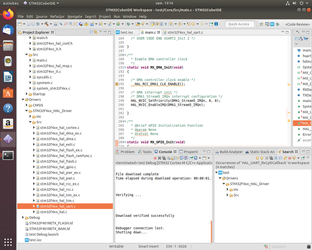

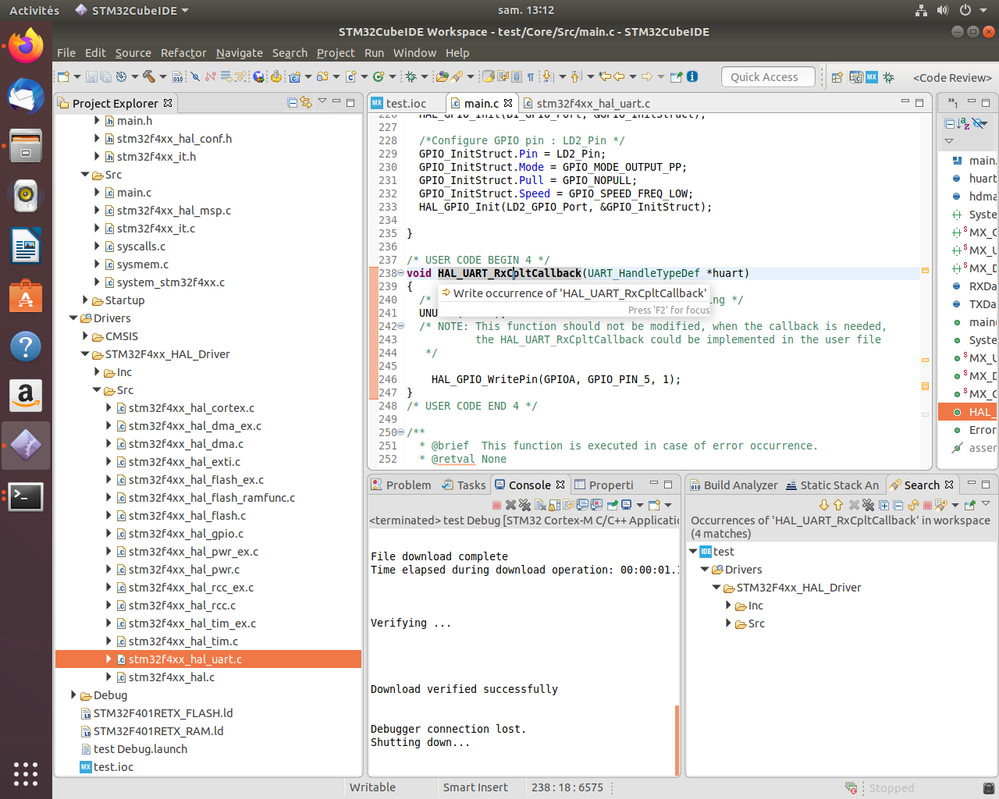

EDIT:
I know the issue now! The function is not declared yet. How can I declare that function so DMA knows that it exist?
/* USER CODE BEGIN 4 */
void HAL_UART_RxCpltCallback(UART_HandleTypeDef *huart)
  /* Prevent unused argument(s) compilation warning */
  UNUSED(huart);
  /* NOTE: This function should not be modified, when the callback is needed,
           the HAL_UART_RxCpltCallback could be implemented in the user file
	HAL_GPIO_WritePin(GPIOA, GPIO_PIN_5, 1); // Nothing happens here
/* USER CODE END 4 */
 The function is avaiable in stm32f4xx_hal_uart.c file.
  * @brief  Rx Transfer completed callbacks.
  * @param  huart  Pointer to a UART_HandleTypeDef structure that contains
  *                the configuration information for the specified UART module.
  * @retval None
__weak void HAL_UART_RxCpltCallback(UART_HandleTypeDef *huart)
  UNUSED(huart);
But if I hover the mouse over the function it looks like this
I'm also got some weird errors on DMA C-code. These errors says Missing ';'

You probably need to initialize DMA before UART in the main().
But I'm using STMCubeIDE. That should be generated by itself. Or is it a bug?
STM32MP151AAC3 custom board with STM32-OS as operating system: https://github.com/DanielMartensson/STM32-Computer
STM32MP257FAK3 custom board with STM64-OS as operating system: https://github.com/DanielMartensson/STM64-Computer
Thank you! That solved my issue. I init the functions like this
