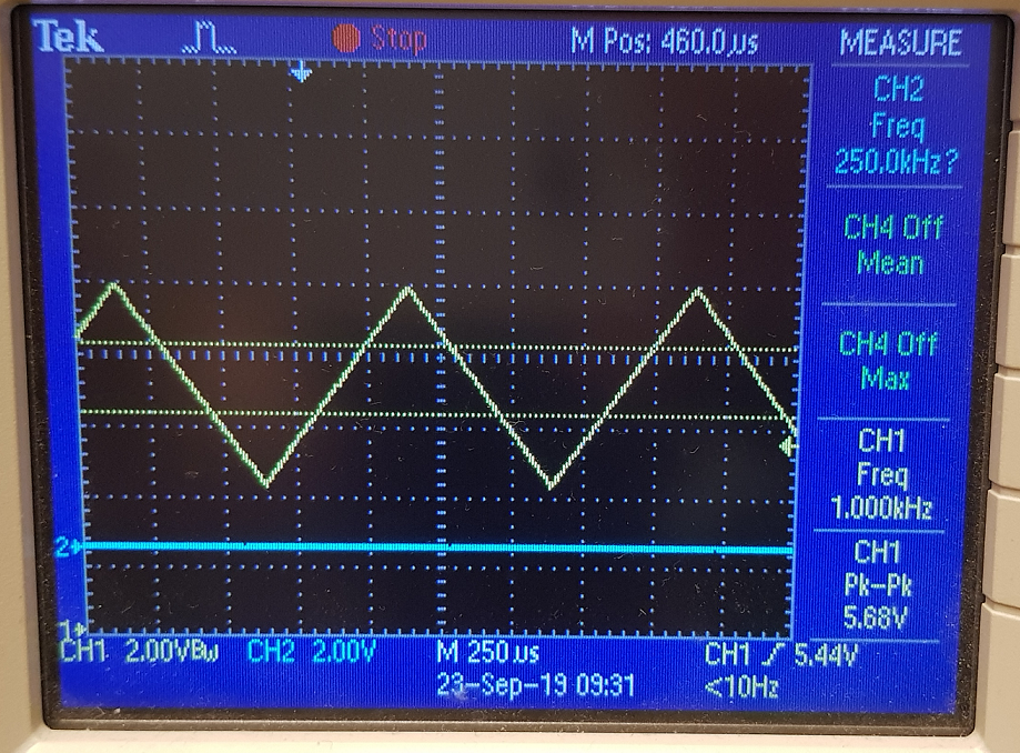

I'm using STM32F746, and the configuring is done with the HAL-library.
In the code below there is a 40 kHz TIM4 interrupt.
The ADC1 & ADC2 is configured in multimode which is triggered by TIM1.
I also use DMA for the ADC data transfer
Each ADC samples 2 channels (ADC1: IN3, IN4), (ADC2: IN5, IN6).
TIM1 is invoked in TIM4 interrupt handler and stopped in TIM1 interrupt handler.

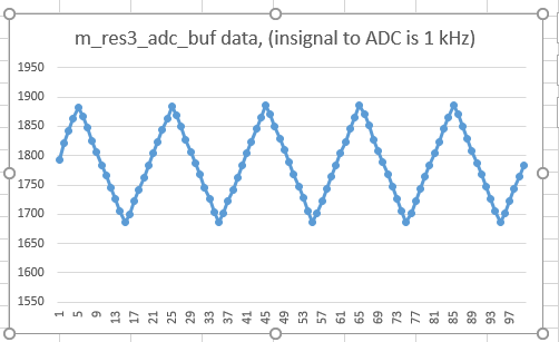

The 4 data from ADC1 & ADC2 are accessible in HAL_ADC_ConvCpltCallback()
The problem is that the ADCs only samples data with 20 kHz instead of 40 kHz.
I have try several different setting but I cannot increase the ADC sampling rate.
Can someone point out what I have done wrong?

The first image below shows that ADC samples only 20 samples during each period even when input signal i 1 kHz. The second image shows the input signal connected to the ADCs input channels.
AJack
Do anyone have any idea what the problem might be?
