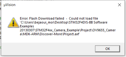

i build the code of "STM32F4DIS-BB Software Examples 20130307: STM32F4xx_Camera_Example" but it can't create the .axf file.
who had an idea?
Thanks.

The build has a FATAL​, try looking at that as nothing downstream is going to work. You can't debug things that don't build.

.\Discover-More\Project.axf: error: L6050U: The code size of this image (33952 bytes) exceeds the maximum allowed for this version of the linker.

Yep. The free Keil license allows up to 32KB.
Try to reduce the size a little (enable size optimization, remove some unused code/data)
