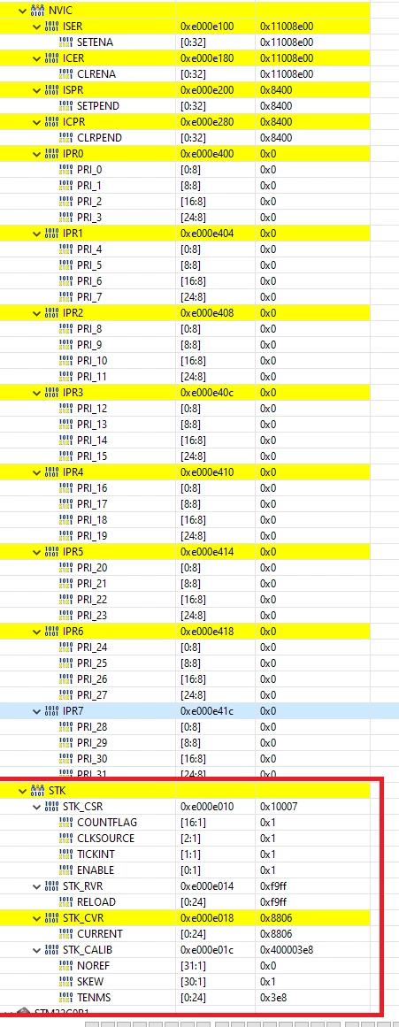

For some obscure reason, sometimes the systick handler function is not called anymore.
I mean, it works for some time then it does not work anymore. It looks like it is more likely to happen when I'm debugging but I have no factual information to provide for this assumption.
Here's the content of the systick registers:
The IT is activated.
VTOR is at adress 0. I don't have any reason to change this.
What can I do to have a clue to understand what happen?
Thanks
Julien

‎2024-08-07 9:08 AM - edited ‎2024-08-07 9:09 AM
SysTick registers look OK.
Maybe your program is stuck in an interrupt? Perhaps in a Cube/HAL delay function?

Ok, Thanks. It took some time to reproduce.
As you can see on this new screenshot :
- There's a breakpoint in the systick interrupt. after some time, the system never stop on it (and the related code is not called, so it's not a breakpoint issue).
- I paused the system, it is not in an interrupt routine
- systick registers are same as in previous post.
- If I continue debug and pause it again, the tick counter value has changed.
I feel like in the dark side...
‎2024-08-08 9:28 AM
Once you are at it, show also the SCB registers' content.

‎2024-08-29 8:44 PM - edited ‎2024-08-29 8:45 PM
VECTACTIVE of 0x1B indicates it is in the DMA1_Ch4_7_DMA2_Ch1_5_DMAMUX1_OVR interrupt. Likely this is blocking and preventing other interrupts from happening.
As @LCE mentioned, ensure systick has the highest (numerically lowest) priority if you want it to take precedence.
Also agreed it's generally bad form to call so many functions within the interrupt, especially the systick interrupt. This isn't purely for style reasons. If things accessed in these functions are also accessed in the main thread, this can lead to race conditions and other bad behavior. You aren't showing too much code here so it's anyone's guess as to what is happening. Surely it is a code bug though, not a silicon failure.
