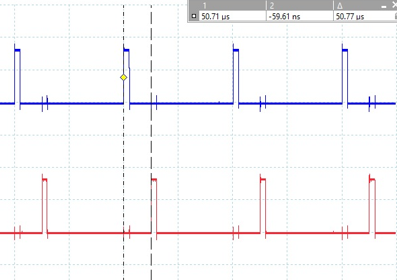

Here's the problem in picture form:
0693W00000JMwz7QAD.pngBoth the blue and red traces are the same frequency and duty cycle, but in this case trace red is offset 50 mS from trace blue.
I managed this on another micro (NXP) where their SCTimer function allows "events" to be associated with the first/red PWM. In this case there are essentially two events tied to trace blue (an on and an off) which result in the trace blue.
Alas, nothing quite so simple appears in the STM32 world, or at least that I've been able to identify (which is probably why NXP crows so much about there SCTimer). Right now, I am thinking I can fiddle with trace red as sort of a modified inverse one shot of trace blue. Seems a little crude, however, I assume there's got to be a better way.

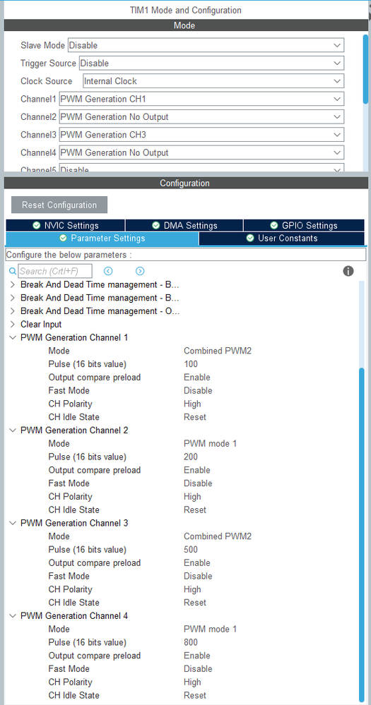

KnarfB
Hi Doug,
can be done with "Combined PWM Mode" for some timers in some series, like TIM1 on G0.
For example, set TIM1
0693W00000JMxTcQAL.pngin main, just start the timer channels:
  MX_TIM1_Init();
  /* USER CODE BEGIN 2 */
  HAL_TIM_PWM_Start(&htim1, TIM_CHANNEL_1 );
  HAL_TIM_PWM_Start(&htim1, TIM_CHANNEL_2 );
  HAL_TIM_PWM_Start(&htim1, TIM_CHANNEL_3 );
  HAL_TIM_PWM_Start(&htim1, TIM_CHANNEL_4 );
  /* USER CODE END 2 */
  /* Infinite loop */
  /* USER CODE BEGIN WHILE */
  while (1)
    /* USER CODE END WHILE */
    /* USER CODE BEGIN 3 */
  /* USER CODE END 3 */

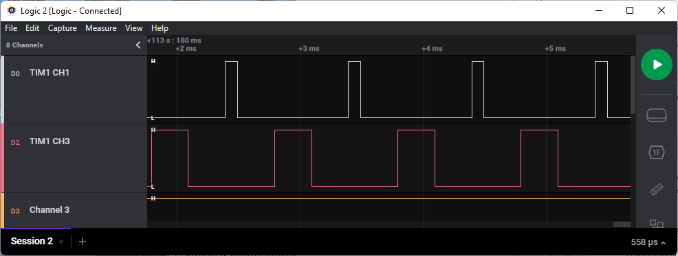

and you will get 2 phase correlated PWMs with independent duty cycles:
0693W00000JMxVDQA1.pnghth

Hey KnarfB:
Thanks for your response! I threw your recommendations into a quick STM32G031-Nucleo project and got the dual synchronized outputs you promised (although quite different from your trace). I need to study your solution and (hopefully) tweak it to meet our requirements, but initially it looks very promising. I owe you a big one here!
Great. I used STM32L432KC with a prescaler down to 1ms/tick and a timer period (ARR) of 1000-1 in case you want to match the waveforms.
