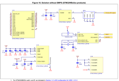

I created a new project with STM32Cube Version: 1.13.2 on Linux, selected my microcontroller (STM32WB35CCU6A), enabled all peripherals necessary (including USB and SWD, haven’t enabled anything RF related (yet)), and tried to upload my code on a brand new IC on a custom PCB. For the PCB, I followed the schematic without SMPS in AN5290 as shown on this screenshot.
I should also mention that I added a 100nF capacitor on nRST, as well as a pulldown on BOOT0 and two push buttons to pull nRST low or to pull BOOT0 high, and I didn’t try to use these pins for my application. Didn’t forget to supply Vbat. For the crystals I made sure to use compatible ones and used appropriate values for the capacitors that go with them. When entering application mode, the board (which contains other devices) draws ~20mA and ~30-40mA when I enter the bootloader with BOOT0. I use a cheap unofficial st-link v2, after connecting to the pc STM32Cube proposed to update the firmware on the st-link, It worked and after this I’m still able to program blue pill board with it (via SWD).

AScha.3
is vddusb connected to vdd ?  cannot see in your circuit...
or
mixed up  swd+swc ? check continuity from cpu-pin to stlink-pin ! (i did this once... :) )
EmptyDemise
Yes Vddusb is connected to Vdd. I cannot really check the connectivity to the pin as the pins are under the package, but I just verified the connectivity to the solder on the pad below the package up to the pins to which the st-link connects and it’s good.

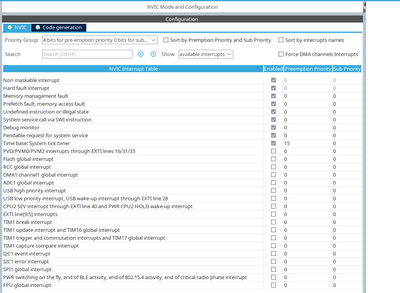

As for the ADC+DMA, if I generate the code without it, upload, everything works, re-generate with circular mode, change nothing else, re-generate and upload the STM32 won’t boot application code anymore. If I comment the MX_DMA_Init(); and MX_ADC1_Init();, then it boots again.
And I just realized that if I uncheck "Force DMA channels Interrupts" which allows me to uncheck "ADC1 Global Interrupt", then it can boot with circular mode and I can use the ADC fine... maybe there is something rotten in my NVIC which also prevents me from using SWD? Though it should work in bootloader mode I think...

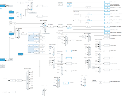

Here’s my current clock tree as well in case this could help
