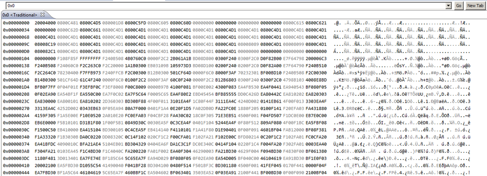

There is no Interrupt vector entry pointing to address
0x20000

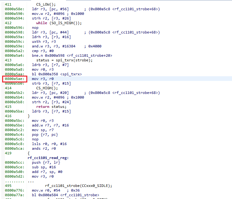

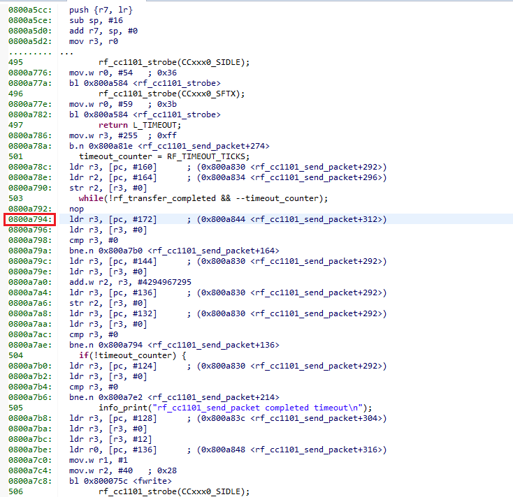

I hope I have the right values:
In Hard Fault Handler
SCB->HFSR = 0x40000000
Forced Hard Fault
SCB->CFSR = 0x20400
Usage fault: Bus fault: r0  = 0xf
r1  = 0x20000fbc
r2  = 0x20200006
r3  = 0x200007ac
r12 = 0x8
lr  = 0x800a5af
pc  = 0x800a794
psr = 0x21000000
Posted on January 23, 2014 at 02:57
Yes, that's a bit perplexing, looks to be signalling an INVSTATE
The code also does not appear to be optimized, but does represent the C, although I can't see the literals it's loading.
Observe that the address of you Hard Fault Handler in the vector table is EVEN (0x080001D8), this will cause a failure, the entries need to be ODD, indicating THUMB code.
I2C1_ER_IRQHandler
I2C2_ER_IRQHandler
SPI2_IRQHandler

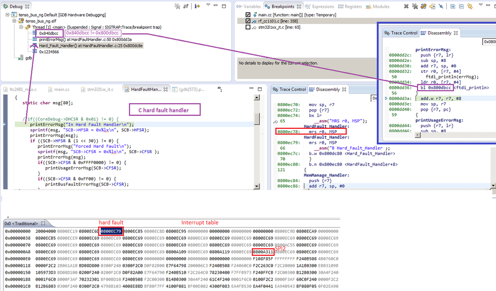

dadman
Posted on January 23, 2014 at 13:21
The code is compiled by gcc 4.7.3 with no optimization -O0
Yes, the address was even, so I've wrapped the ASM code to C:
extern void Hard_Fault_Handler(uint32_t stack[]);
__attribute__ ((naked)) void HardFault_Handler(void)
__asm(''MRS r0, MSP'');
__asm(''B Hard_Fault_Handler'');
Now the address of the Hard Fault handler is odd and all other handlers as well, see the next picture, the lowest part.
But I'm not sure if it is OK that Eclipse debugger shows the Hardfault handler on the nearest lower even address. See the picture, red frames.
After the change I had run the code again and GOT SPI2_IRQ. I was very happy but just for one minute. Because the SPI2_IRQ happened just twice from many tens of tests. :-(.
For example I've got the following result:
If I have breakpoint at start of the HardFault_handler, I'm able to step the handler and print the stack and so on.
BUT if I remove the breakpoint the HardFault_handler crashes as shown (purple color).
You can see that the function ftdi_println() at address 0x800dbcc is not called because the address is changed to 0x840dbcc. Just one bit is changed.
My interpretations is that this is some memory bus problem because of hw problems.
The Hard Fault is always caused by touching the PCB by my hand.
Am I right?
The faults in the Hard fault handler disallow me to use serial debugging without SWD :-(.
But for example division by zero fault (manually added to code before the fault critical code)  works well, Hard Fault handler catches it a correctly print to serial port the stack.
