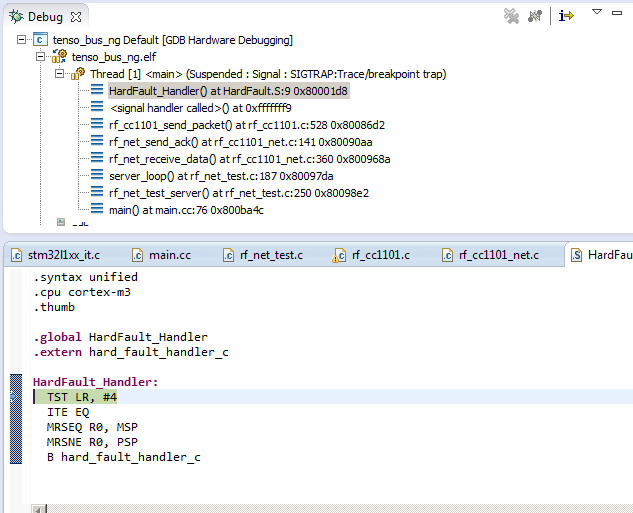

Additional information:
Hard Fault handler routine (see attachment for ASM code) output:
[Hard fault handler - all numbers in hex]
R0 = 20004000
R1 = 800c405 - ResetHandler
R2 = 800c459 - NMIHandler
R3 = 80001d8 - HardFault_handler
R12 = 800c581 - MemManage_handler
LR [R14] = 800c589 subroutine call return address - BusFaultHandler
PC [R15] = 800c591 program counter - UsageFault Handler
PSR = 0
BFAR = e000edf8
CFSR = 30000
HFSR = 40000000
DFSR = 3
AFSR = 0
SCB_SHCSR= 0
Registers when Hard Fault occurred
Eclipse stack trace

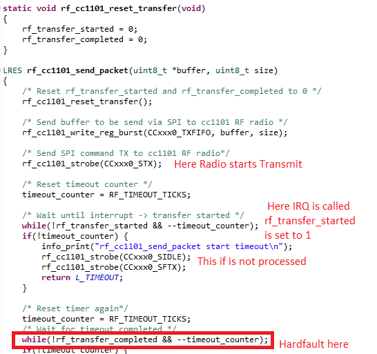

And the code when HardFault occured - wait cycle, just decrementing uint32_t and wainting for modification of volatile integer from IRQ handler.
Thank you very much for your help.

Posted on January 22, 2014 at 02:42
Your Hard Fault handler hex output suggests it's dumping the vector table (at zero), and not register or stack content.
PSP = 0 ??
It would be helpful if you display the other register list in hex, you look at the faulting instructions in assembler, and you hex dump the stack.
If it really goes into process mode, as perhaps a result of a corrupted stack return from interrupt, and the stack is pointing at zero, you can surely expect it to fault.
So figure out the scope of your stack (0x20004000 .. 0x20003F58), see how deep it really gets, look at what you have as local/auto allocations within normal code, and under interrupt. Fill the stack with a known marker so you can observe the low water mark.

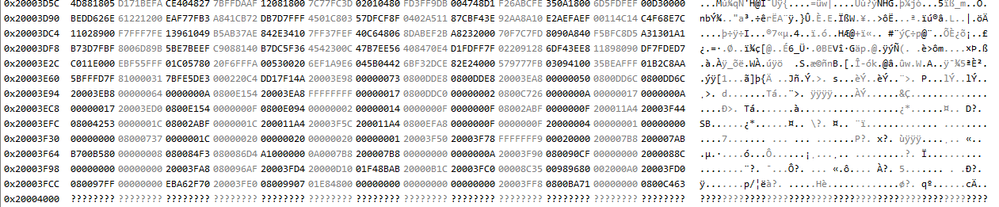

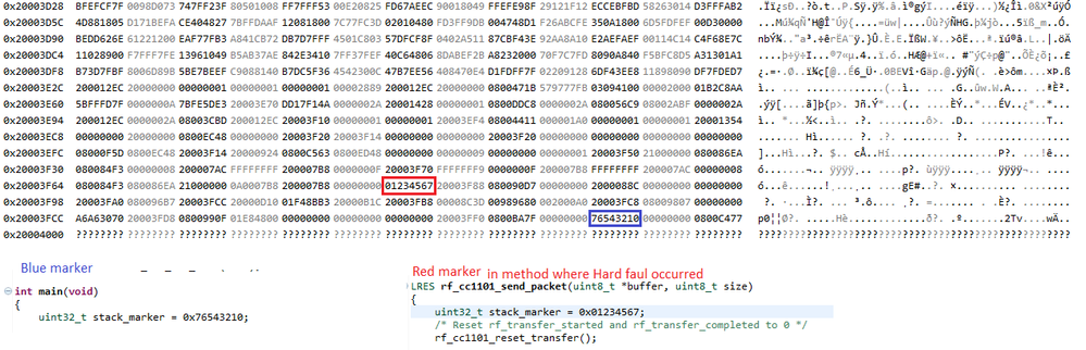

dadman
Posted on January 22, 2014 at 10:14
I did several tests and found another workaround for the HardFault issue.
I've attached Oscilloscope probe to the SPI MISO Pin and IRQ Pin from RF and the problem disappeared and the application is running perfectly stable. (The same is done by initializing GPIO6 PIN).
When the probe is disconnected it immediately Hard faults.
I've also tried to connect IRQ PIN a SPI MISO via 10k resistors to ground but it doesn't help.
I've also tried to connect to IRQ PIN a SPI MISO 100pF to ground and it helped a little. The system is now stable but when I have touched the bootom of the PCB the hard fault occurred again.
I'm still more and more convinced that this is some hardware-related problem around GPIO or SPI bus.
Thanks for any advice.
Jakub

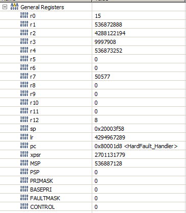

dadman
Registers when Hard fault occurred:
R0 -      0x7a
R1 -      0x200007bb
R2 -      0
R3 -      0x20004014
R4 -      0x800c439
R5-       0x848d
R6-       0x80001d8
R7-       0x85b5
R8-       0
R9-       0
R10-     0
R11-     0
R12-     0
SP-      0x20003f40
LR-       0xfffffff9
PC-      0x80001d8
XPSR-  0x41000003
MSP-   0x20003f40
PSP-          0
PRIMASK-  0
BASEPRI-   0
FAULTMASK 0
CONTROL   0
PSP is 0 during the whole program execution.

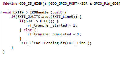

The IRQ handler is very simple.
The problem occurs in routine for sending packets.
I've traced the all instructions in debugger up to the place where Hard fault occured.
No suspicious local variables (only int result codes etc).
No memory operations like memcpy on stack variables.
Stack dump after Hard fault
Another run with stack markers
Posted on January 22, 2014 at 16:58
I can't particularly understand why the Hard Fault routine was passed 0, here with an LR entry of 0xFFFFFFF9 it pulls the stack from MSP
Looking at the stack frame as is, we have
0x20 r0
0x20 r1
1 r2
0x20003F50 r3
0x20003F78 r12
0xFFFFFFF9 lr
0x00020000 pc
So it looks to be coming from some other interrupt or fault (LR), the PC is invalid (EVEN)
Your code itself looks innocuous, even without the disassembly, or knowing if the variables are volatile. The issue is elsewhere.
You should examine all your interrupt vector entries, looking for the unfilled ones, or ones containing 0x20000
You should consider what other interrupts or DMA you have enabled, or could be occurring.
You want to double check your clock settings, flash wait state and prefetch configuration.
You want to see if there is some voltage spike, or short, or GPIO connected with the RF sending/completing.
dadman
Posted on January 22, 2014 at 17:18
Hi Clive,
at first thank for your help.
Yes variables are static volatile
There is no other IRQ handler enabled, only SysTick_Handler is running.
static volatile uint32_t TimingDelay;
void SysTick_Handler(void)
if (TimingDelay != 0x00) {
TimingDelay--;
