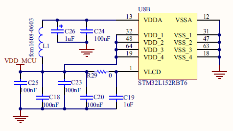

The extra bit is troubling, I guess you'd want to suspect speed/voltage and prefetch. The prefetch path is one of the critical ones, and low voltages will slow things down, including the flash.
Do you have some bulk capacitance close into the supply pins, along with the decoupling caps? This is from the L1-DISCO, C19 is not a tant, and I might look to get a 1uF or 2.2uF close in on the VDD side, especially if the RF TX pulls a lot of instantaneous current, and you'd want it on the chip side of the inductor/choke

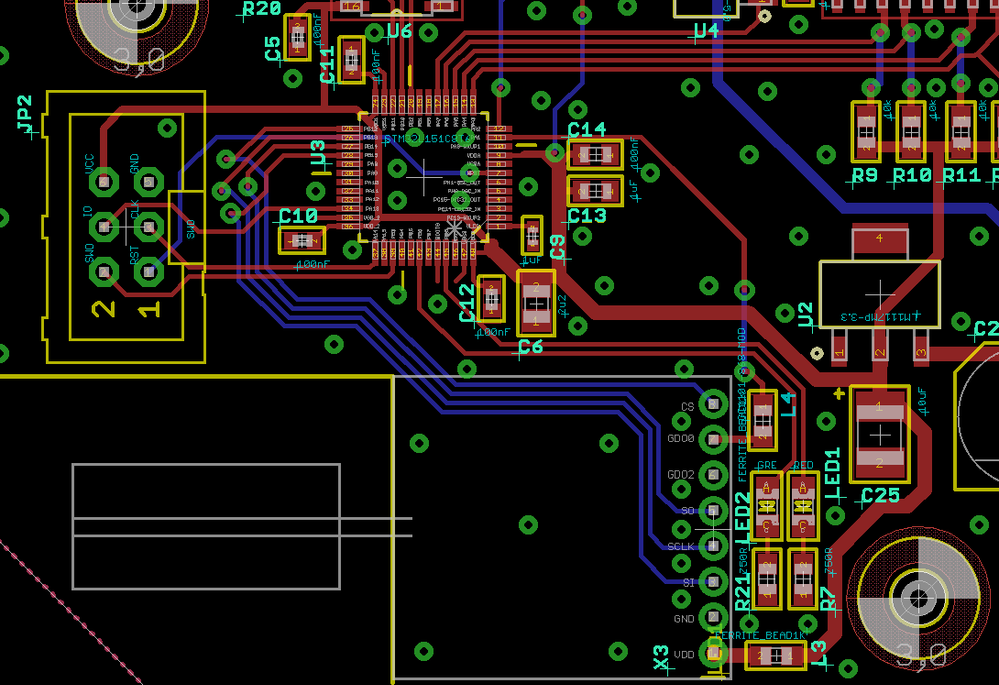

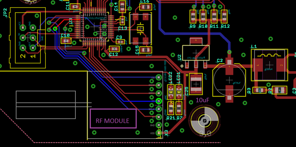

This is my pcb with capacitances. This is done based on recommendations from STM32L152 Disovery kit (almost the same like your schematic). No bulk capacitance near of VDD pins. I have tried to add 1uF to C12 in parallel with no success. The 10uF tantalum is one inch far from MCU near to LDO. No chokes.
Don't look at the MCU name on schmatic STM32L152CBT6 is used

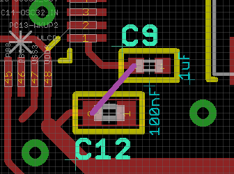

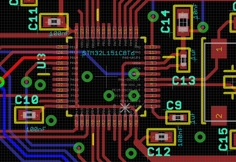

Do you have an LCD? Is there connectivity here? Illustrated in PURPLE
Or any other bulk cap on the VDD side? You mentioned the one on the supply, but that's presumably there for the regulator, and on current path shared with the RF module.
Edit: Never mind is see the net attached to VDDA, but not sure you want to connect the nets like that, as all the digital noise routes through the VDDA pin to get to it's charge storage.
dadman
Posted on January 24, 2014 at 17:14
I have no LCD. I have  no the puple connection in my design. But I've tried to connect it by wire + add 1uF directly parallel with C12.

No other cap except the shared LDO 10uF. (but I've tried the 1uF as mentioned before)

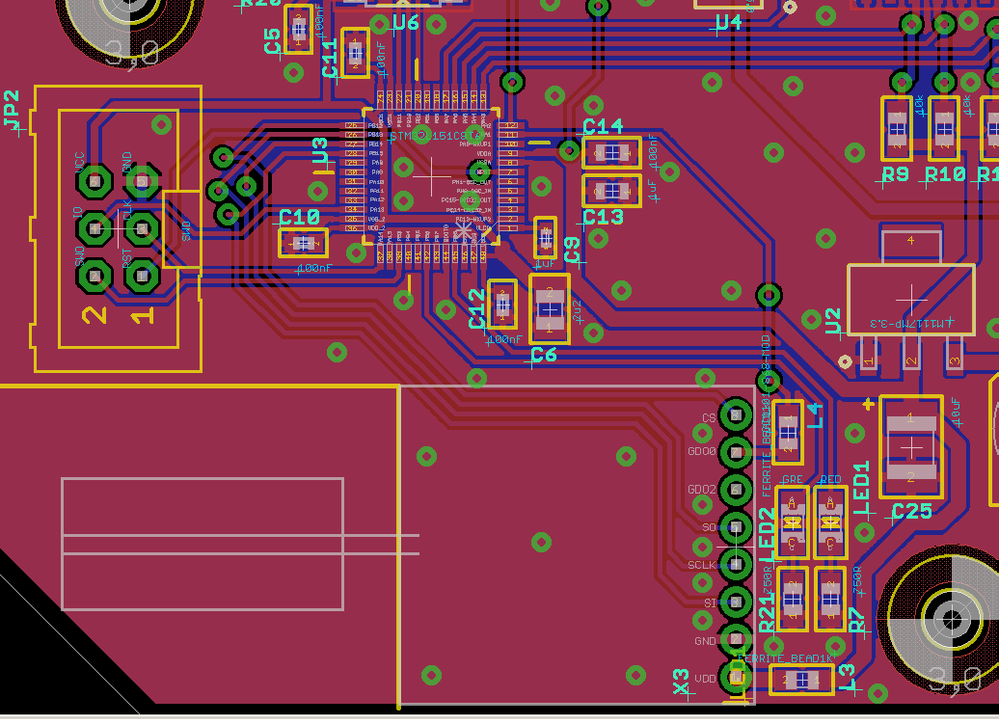

I'm not using ADC but I will change it. I including the more from the PCB layout to see the overall layout.

The Ferrite beads that help mi solve the problem are near to symbol X3 on VDD path to RF module and near to pin PB5.

I'm guessing this is a 2-layer board, with grounding on the back, or perhaps 4-layer.
I probably would have done a couple of things a bit different.
I'd have a top layer ground immediately under the RF module, and not route signals directly under the module. For the 2-layer putting the signal routing on the back, and pulling the routing closer to the pin connector end, away from the antenna, and active portion of the TX circuits/amps.
I would have bifurcated the 3V at C25, taking the RF module supply around the right side, and the supply to the STM32 from the left.
I would have widened the trace width for the supply under the STM32, and to circuitry beyond it, and reconfigure the VDDA flow wrt to the bulk/decoupling.
For 2-layer board power routing tends to be a problem, I tend to think of it like plumbing, the pipes need to be thick by the supply, tapering to the end-points
