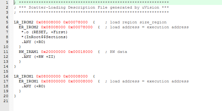

I edited the scatter file as following but it does not work.
After rebuilding and running, the application does not run from the address 0x8008000. it runs from another addresses and run an old code.  Any Advice???
This is the scatter file

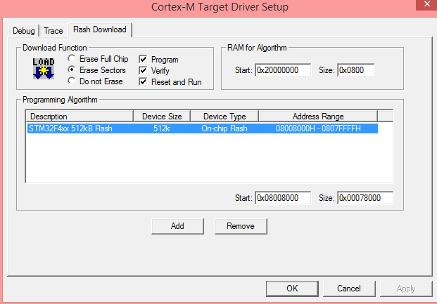

I also edited the programming algorithm as following:

S.Ma
Principal
Posted on October 30, 2017 at 08:29
Find the linker spec to edit the STM32 memory segments addresses and shrink the code one, add your specific sector area for your own use. Otherwise, the linker will fillup the flash area from bottom to top with global constants and code.
