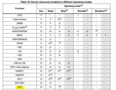

Hello @uveuvenouve,
Waking up from shutdown mode using ADC events is not typically supported because the ADC is already powered down in shutdown mode, Please check this table in RM0490:
‎2024-06-18 1:11 AM
Hi Sarra,
Thanks for your information.
The problem is i cannot enter shutdown mode with that 3 line of code.
I saw some information for shutdown mode and I know the clock will be suspended which mean ADC will not be able to work
So I wonder whether sleep mode can do such a thing
On the table ,it state "U" in sleep mode for ADC, which is unchanged.
The point is i want to deploy a function that adc wake the mcu from sleep mode with low layer lib, but I can't find examples.
1. enter sleep mode and shutdown mode
2. set up WFE/WFI with ADC

To enter shutdown mode, you can follow this sequence
LL_PWR_SetPowerMode(LL_PWR_MODE_SHUTDOWN;
LL_LPM_EnableDeepSleep();
LL_PWR_ClearFlag_WU(); //clear any pending wake-up flags that might inadvertently wake up the MCU immediately after entering shutdown mode
__WFI(); // In shutdown mode, the __WFE(); instruction is typically not used because most peripherals, including the event system, are powered down.
You can use either the __WFE(); or __WFI(); instruction to enter sleep mode
the note "Unchanged" in Sleep mode means that the peripheral retains its state or configuration and continues to operate as it did before entering Sleep mode so it is possible to use it.
