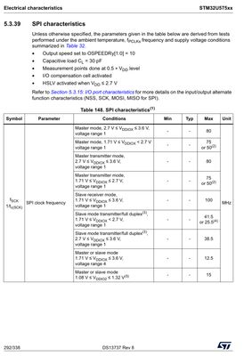

I was expecting to see SPI3 as slave receiver working up to the same speed as OCTOSPI (80 MHz).
But it works only up to 53.333 MHz (but still OK for my purpose, 40 MHz as "regular SPI via OCTOSPI as QSPI).
OK, the same statements found in U5A5 datasheet (not using U575):
100 MHz as SPI Slave, VDD=1V8 should be possible.
(1.71 V ≤ VDDIOX ≤ 3.6 V, voltage range 1)

The duty cycle maybe matters (50%, as mentioned in note 3):
3. The maximum frequency in slave transmitter mode is determined by the sum of tv(SO) and tsu(MI) that has to fit into SCK low
or high phase preceding the SCK sampling edge. This value can be achieved when the SPI communicates with a master
having tsu(MI) = 0 while Duty(SCK) = 50%.
This one I cannot influence: it is generated by the OCTOSPI.
I run voltage range 1.
