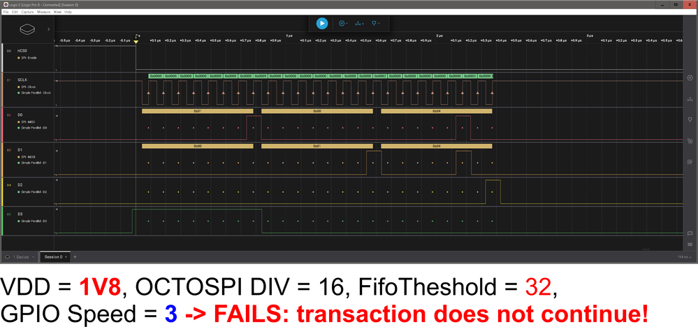

This is more a bug report, not a question.
Background:
I want to use OCTALSPI as QuadSPI (QSPI), esp. with VDD set to 1V8. I want to get (at least) 30 MHz SCLK working on QSPI.
But I cannot go faster as 12.195 MHz, which is associated with a OCTALSPI clock divider set to: 13.
Symptoms:

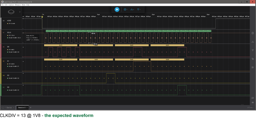

VDD = 3V3:
down to clock divider = 13 - all looks fine
clock divider lower (for faster speed): looks different on SCLK but might be OK (still reasonable, even with gaps)

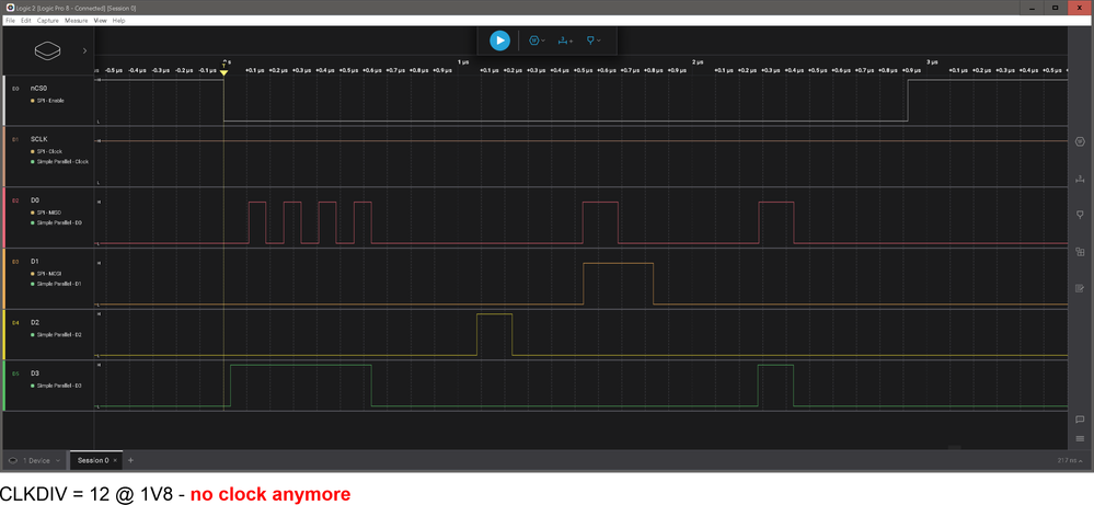

the minimum for clock divider with VDD = 3V3 is: 6 (resulting in 27.778 MHz - I want to see 30 MHz working)
anything faster (smaller clock divider) FAILS: there is no SCLK anymore
VDD = 1V8:
all fine down to clock divider = 13 - the same as 3V3
clock divider = 12 - FAILS completely! no SCLK anymore!
with VDD = 1V8: I cannot even reach the same speed as with 3V3

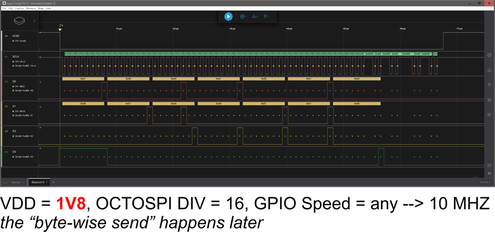

VDD = 1V8:
It fails immediately with CLKDIV = 12 - where it was working still (a bit) with 3V3!
What is wrong?

Observations:
  1. the "byte bursts" depend on Debug code vs. Release code:
    if I set optimization to -g0 and -O3 - it happens later.
    But it happens: the longer the QSPI transaction, or the faster the speed - the following data words come as "byte burst" (not as words burst, never mind what the FIFO setting is).
  2. The GPIO Speed setting has FOR SURE a dramatic impact, if it is working or not (Speed setting as "fastest" makes it working for faster QSPI speed, slower GPIO speed makes the QSPI failing).
I am closing this ticket, even I did not have a clue how to avoid the "byte burst" and why GPIO speed setting matters so match to see a SCK signal on scope.

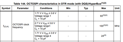

I am frustrated. I have changed to STM32U5xx because of the QSPI support (even it lacks some features, like "regular SPI"). Now I realize that it does not work as specified (in datasheet), e.g. to get 93 MHz SCLK in voltage range 1, even on VDD = 1V8. I get just 27 MHz maximum (and just with 3V3, not 1V8).

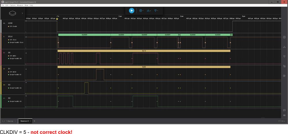

Even setting PLL2Q to 200 MHz (as mentioned in RM) - FAILS!
(the SCLK stalls later an data transmission part, CMD, ADDR, ALT are still OK, but no SCLK on QSPI Write data sequence)

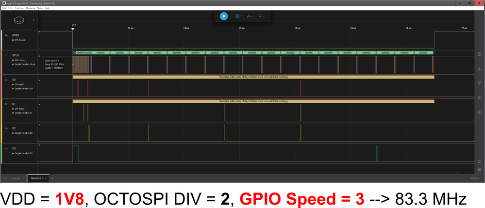

I've found a "trick": GPIO speed setting

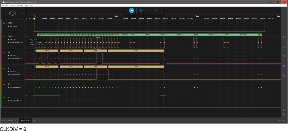

When I configure the GPIO speed to 3 (slew rate) - I can reach 83.3 MHz on VDD = 1V8. OK, great!
But:
  • I have seen issues with cross-talk when GPIO speed is 3 (fastest slew rate): I saw some "glitches" (cross-talk) on NCS signal (wrong pulses). Not sure if cross-talks happens inside chip or on my external wiring.
  • Why are the words coming in byte bursts? I have configured for 32bit. The slower the speed (larger DIV), e.g. OCTALSPI DIV = 16 - it starts later when it changes to these "byte bursts".
  • I am expecting to see gaps between 32bit words (due to polling status for free FIFO) - but not gaps when 32bit words are sent (expecting 8 clocks without a gap)
Very strange behavior.
I tried with FIFO threshold - no change: the 32bit words are still split into a byte burst transfers. WHY?
(how to get 32bit words shifted out with 8 clocks without a gap during a word? ok to have gaps between words but not assuming during a word)

Conclusion for now:
In order to get more as 12 Mbps on OCTALSPI, on VDD = 1V8 - I have to use the GPIO Speed setting (set to fastest slew rate). But why?
