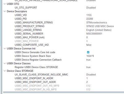

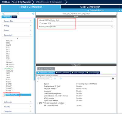

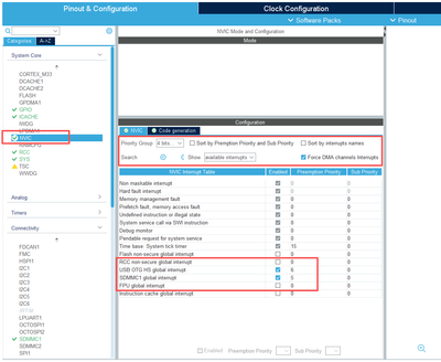

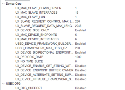

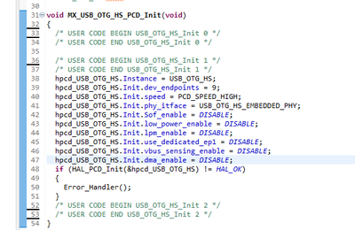

I am also using this board and STM32Cube_FW_U5_V1.8.0 to create a USBX stand-alone (without THREADX) MSC device,but struggling to get the board to enumerate with the PC.
I'm not sure if it's a configuration issue or a code modification problem.
Below are my configurations and code modification points.
Could you please help analyze them? Thank you very much!

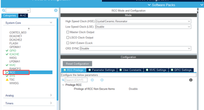

configurations:
USB_OGT_HS:
NVIC:
RCC:
SYS:
USBX:
tod_4-1757551208475.pngtod_5-1757551212555.pngtod_6-1757551216152.pngtod_7-1757551233581.png

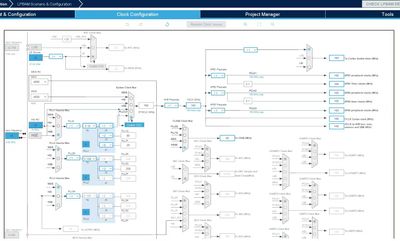

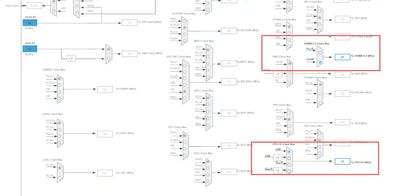

clock tree:

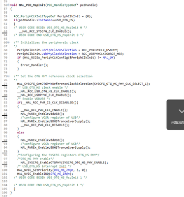

code:
UINT MX_USBX_Device_Init(VOID)
//default code
/* USER CODE BEGIN MX_USBX_Device_Init1 */
USBX_APP_Device_Init();
/* USER CODE END MX_USBX_Device_Init1 */
return ret;
USBX_APP_Device_Init:
MX_USB_OTG_HS_PCD_Init:
HAL_PCD_MspInit:

FBL
Hello @tod
Here is working full setup for MSC standalone using USBX. It seems CubeMX is missing RCC clock configuration in HAL_PCD_MspInit()
    __HAL_RCC_SYSCFG_CLK_ENABLE();
Best regards,
FBL

FBL
Hello @tod
Best regards,
FBL
tod
Hi @FBL
Thanks a lot !!!!!
After making modifications based on your suggestions, the enumeration process now works correctly, and an empty drive letter (Removable Disk (H:)) is detected.
