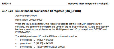

I have two NUCLEO-H563ZI EVB boards  and tried to implement I3C controller and target feature.
When ENTDAA was issued, I obtained the target 48-bit provisioned ID "0x020813810100" from waveform, I saw the description from I3C register  I3C_EPIDR ,it said" Bits[31:16] of the provisioned ID can be 0" but I got the actual value is "0x1381",so where is this value stored?
In addition, it seems that the target can issue a 48 bit provided ID without software operation , is this sending process entirely completed by MCU hardware?

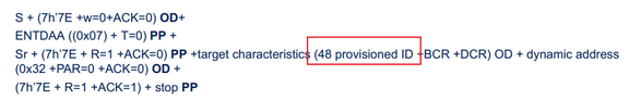

hi Foued,
Yes, I know the I3C_EPIDR register, but I want to confirm the 48-bit provisioned ID in the ENTDAA process(dynamic address assignment).
I obtained a"48-bit provisioned ID" from the waveform, with a value of 0x020813810100. But I don't know why the target board could send it, because this value is not present in the example code .Could you help to explain it?Thanks.
In order to support the Dynamic Address Assignment procedure, each I3C Device to be connected to an I3C Bus shall be uniquely identifiable before starting the procedure :
- The Device shall have a 48-bit Provisioned ID ( for example : for I3C sensors you can find this value in the Datasheet : like LSM6DSO , LPS22HH , ...)
The 48-bit Provisioned ID shall be transferred continuously, starting with the most significant bit (bit[47]).
So the Device whose concatenated Provisioned ID, BCR, and DCR has the lowest value will win the Arbitration round, due to the nature of Arbitration. ( if more than one I3C device on the I3C bus )
Hope it helps!

Hello @Garry ,
Could you please check section 49.16.28 ( RM0481  v2 ).
the bits[31:16] of provisioned ID can be 0 but in the case if you are using STM32 as I3C target ,the provisioned ID is "13 81".
Br,
Foued

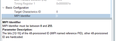

Hi Foued,
what kind of software used to write 4-bit MIPI Instance ID ?
can I write unique MIPI instance ID for ILPS28QSW sensor (up to 16)?
Thanks
Hello @mdaud ,
For sensor no need to add a software for target . ( in case you have STM32 as a target you need to identify the MIPI instance ID )
Foued

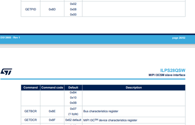

Hi Foued,
Noted, How about for sensor, can I have multiple ILPS28QSW in single I3C bus ?
I was thinking to connect 12 pcs of ILPS28QSW.
Thanks
I think you can't connect 12 pcs of ILPS28QSW on I3C bus. ( only one PID , BCR and DCR )
