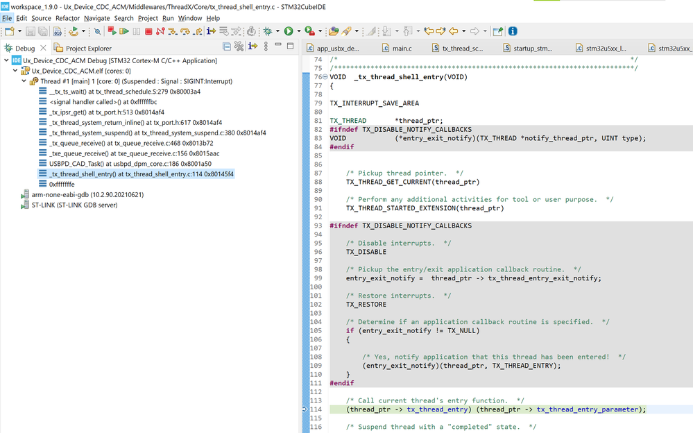

My project use STM32U595 chip. It will use HS USB to send large amount data to computer.
I use NUCLEO-U5A5ZJ-Q for testing.
The project use Ux_Device_CDC_ACM in NUCLEO-U5A5ZJ-Q of STM32Cube_FW_U5_V1.4.0.
I reference this post https://community.st.com/t5/stm32-mcus-products/nucleo-u5a5zj-q-usb-cdc-acm-issue-with-ux-device-class-cdc-acm/td-p/632086
I modify a little bit of Kannan1's code as:
#define MAX_PKT_SIZE 2048
//512 /* 200 */ /* 512 */ /* 1024 */
#define TOTALBYTE APP_TX_DATA_SIZE*1000
#define USEHAL

So I only modify the function VOID usbx_cdc_acm_write_thread_entry(ULONG thread_input) and VOID USBX_APP_Device_Init(VOID). didn't touch other in original project.
when I set:
it can successfully send the amount data to computer couple of times when I pushed the button. Then the code is locked.
when #define TOTALBYTE APP_TX_DATA_SIZE*1000
it locked at first time.

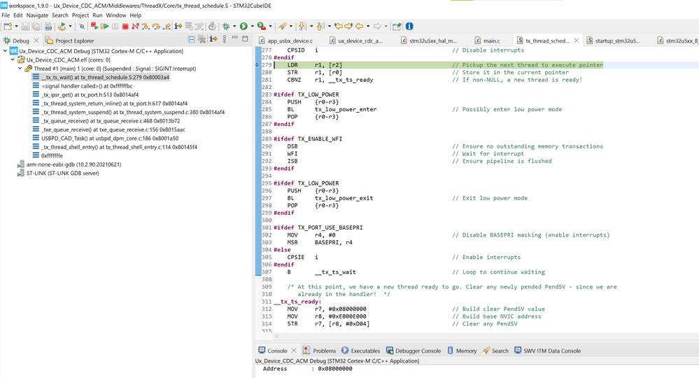

When locked, the debug show as:
Does anyone know what is the problem? Thanks.

I find the problem:
I use Realterm on windows10 as serial port terminal. This software has issue for receiving no ASCII character.
When I write C++ code to handle the virtual serial port. The STM32U5A5 can complete all data at 4MBPS rate.
