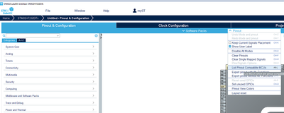

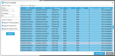

You can check the compatibility pin by using the STM32CubeMX. This toolchain allows you to know the list of MCUs with Pinout compatible, you just need to start by creating a new project using your MCU part number (STM32H723ZGT6 in your case) and press Pinout to get the list of all compatible MCUs as presented in the below figures:
Note that also when compared STM32H723 to STM32H74x/75x devices, STM32H72/73x devices offer the following additional features:
• two OCTOSPI interfaces, instead of a single QUADSPI
• possibility to store encrypted code or data on external Octo-SPI memories (for STM32H73x devices)
• a parallel synchronous slave interface (PSSI)
• a digital temperature sensor
