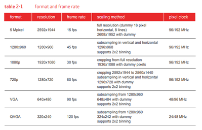

 After doing this, the logic analyzer output showed about 7.5fps. This seems somewhat low, since the OV5640 camera's datasheet claims its maximum can be 120fps at the 320x240 resolution. So I wanted to ask if there are any suggestions for improving the frame rate. My company is working on a project that would like to achieve at least 720p 15fps with a similar setup.

If I wanted to try increasing the framerate even more i.e., I was trying to maximize it on this STM chip (recall my goal is 15fps but on 720p resolution), do you know if that's just simply increasing the value in OV5640_SC_PLL_CONTRL2 even more? From a quick glance at the datasheet, that's what I've guessed the PLL multiplier is somewhat, if not directly, used for.

To modify the resolution, I advise you to refer to this table in the OV5640 datasheet and to 6.4 DMA configuration in AN5020.
