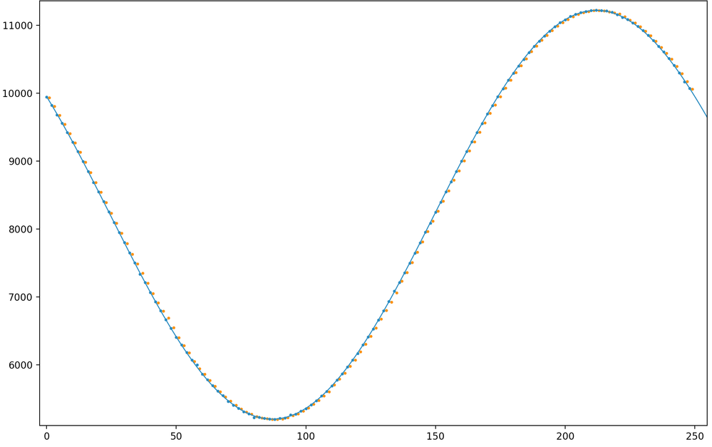

I've also included a screenshot of what I am seeing from my ADC samples. This is measuring a 1 kHz sine wave at 250 ksps, reading channel 15 twice in each sequence (as configured in the registers above), for a duration of 1 ms. So, there are 250 samples total, with 125 of them for the first channel in the sequence and the other 125 for the second channel in the sequence (again, both of which are channel 15).
In the graph, the X coordinates are increasing with sample number (sample 0 is the first conversion from sequence 0, sample 1 is the second conversion from sequence 0, sample 2 is the first conversion from sequence 1, etc...). My expectation was that all points would lie on the sine wave which would be the case if the second sample in the sequence was waiting for my TIM trigger. Instead, it is clear that the second sample is being taken very soon after the first sample in each sequence. Note that there is some noise in my hardware which is a Nucleo board and a bunch of jumpers that are not well shielded, but the samples from 150-250 are pretty clean here and show the problem clearly.

So, I tried with SMPTRIG mode instead of BULB mode and it does not seem to work at all if your sequence has more than one channel. I will open a tech support ticket to ask about that.
My conclusion is that it might not be possible to sample more than one channel on a regular tick that doesn't correspond to one of the ADC's built-in sample times, otherwise I could just use continuous mode.
2023-02-10 6:47 PM
I wrote too soon! Using discontinuous mode and bulb mode together seems to work, using DISCEN=1 and DISCNUM=0 (1 channel). Each trigger advances just to the next channel so the samples are all equidistant in time. Hopefully the bulb sampling is active between triggers.
