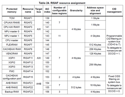

‎2025-01-10 7:17 AM
Hello!
you need to configure the Resource isolation slave unit for address space protection in order to let the HPDMA1 master to have access to SRAM2 or SRAM1
/*RISAF2 => SRAM1_AXI */
/*RISAF3 => SRAM2_AXI */
RISAF3->REG[0].CFGR = 0x00000000;
RISAF3->REG[1].CFGR = 0x00000000;
RISAF3->REG[0].CIDCFGR = 0x000F000F; /* RW for everyone */
RISAF3->REG[0].ENDR = 0xFFFFFFFF; /* all-encompassing */
RISAF3->REG[0].CFGR = 0x00000101; /* enabled, secure, unprivileged for everyone */
RISAF3->REG[1].CIDCFGR = 0x00FF00FF; /* RW for everyone */
RISAF3->REG[1].ENDR = 0xFFFFFFFF; /* all-encompassing */
RISAF3->REG[1].CFGR = 0x00000001; /* enabled, non-secure, unprivileged*/
For further information see the chapter 7. Resource isolation slave unit for address space
protection of the reference manual RM0486.

‎2025-01-10 11:48 AM
Hello @ANJS,
Thank you! That worked.
Since I don't care about that security/isolation stuff one bit, is there a way to disable it altogether?
Can I iterate through all of these RISAF regions, configure them the same way as you suggested and forget about it?
