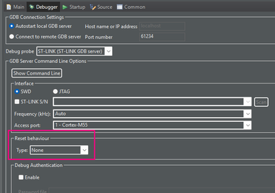

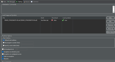

I use the following approach for the XIP configuration.
The FSBL is without changes.
In the Appli code, in main.c, add code as shown below. Make sure that the debugger does load symbols from Aplpli ELF only, and does not download the firmware, and does not reset the chip (see the pics below).
Now you can power up (or reset) the board after flashing, run the Appli debug, set breakpoints and press the USER1 button to debug.
