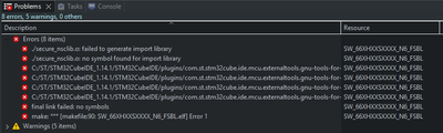

I am developing bootloader application inside of FSBL project. When I build the project, I am getting error. You can see error below.
I did some search about "DSO" but I did not find exactly what cause this error or how should I fix this? Because my application and extmemloader has same configuration and I can build them.
(I changed GNU tool version for FSBL but it also did not work.)
Thanks for help,
Best Regards.

C:/ST/STM32CubeIDE_1.14.1/STM32CubeIDE/plugins/com.st.stm32cube.ide.mcu.externaltools.gnu-tools-for-stm32.13.3.rel1.win32_1.0.0.202411081344/tools/bin/../lib/gcc/arm-none-eabi/13.3.1/../../../../arm-none-eabi/bin/ld.exe: warning: cannot find entry symbol Reset_Handler; defaulting to 34180400
C:/ST/STM32CubeIDE_1.14.1/STM32CubeIDE/plugins/com.st.stm32cube.ide.mcu.externaltools.gnu-tools-for-stm32.13.3.rel1.win32_1.0.0.202411081344/tools/bin/../lib/gcc/arm-none-eabi/13.3.1/../../../../arm-none-eabi/bin/ld.exe: ./secure_nsclib.o: no symbol found for import library
C:/ST/STM32CubeIDE_1.14.1/STM32CubeIDE/plugins/com.st.stm32cube.ide.mcu.externaltools.gnu-tools-for-stm32.13.3.rel1.win32_1.0.0.202411081344/tools/bin/../lib/gcc/arm-none-eabi/13.3.1/../../../../arm-none-eabi/bin/ld.exe: ./secure_nsclib.o: failed to generate import library
C:/ST/STM32CubeIDE_1.14.1/STM32CubeIDE/plugins/com.st.stm32cube.ide.mcu.externaltools.gnu-tools-for-stm32.13.3.rel1.win32_1.0.0.202411081344/tools/bin/../lib/gcc/arm-none-eabi/13.3.1/../../../../arm-none-eabi/bin/ld.exe: final link failed: no symbols
collect2.exe: error: ld returned 1 exit status
make: *** [makefile:90: SW_66XHXXSXXXX_N6_FSBL.elf] Error 1
"make -j20 all" terminated with exit code 2. Build might be incomplete.

‎2025-06-18 2:41 AM
Problem was not about DOS!
In the first place, I tought that there are some invisible variables inside of include files but I figured out that root folder is deleted from "Source Location". Therefore, FSBL project did not find the "Secure_nsclib" location.
Best Regards.

It would be more helpful if you described how you fixed it - for the benefit of people who may find this in a search, trying to solve the same problem...
