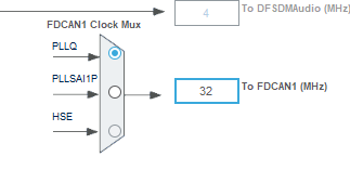

We are using CAN on STM32L562 in classic mode.
After configuring, we se FDCAN.PSR.ACT to be 1 as can be seen in screenshot below.
This means, node is neither receiver nor transmitter.
Why is this happening ?
We are able to receive the data, but the CAN controller does not send the ACK when a frame is received which results in retransmission of the frame from the transmitting node.

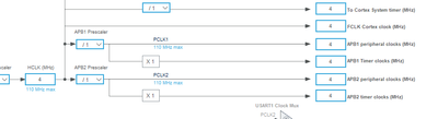

According to what you shared till now:
1) It's not recommended to use any of the internal clock sources (RC based oscillators: HSI, MSI etc) for CAN communication. Please use HSE with a crystal.
2) From your clock configuration you have APB clock = 4MHz while FDCAN kernel clock = 32MHz:
and you need to have fdcan_tq_ck  <  fdcan_pclk as stated in this knowledge base article:
FAQ: Fixing STM32 FDCAN communication disruptions - APB bus, kernel, and time quanta clocks
