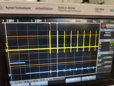

i am performing some 400bytes blocks transferts by SPI, at 16Mhz.
I have NSS off, so no CS up/down between frames.
From some testing, whatever system clock i set, or whatever spi clock i set, there is a fixed 4us time between 2 consecutive frames. This pause is of course very visible and heavy at 20Mhz spi clock, by scope something like:
__||||||||_____________||||||||______________|||||||_____
Transfer is done by LL_SPI_TransmitData8
If any help to reduce this delay between frames, would be very good, or at least to know i cannot reduce it in any way will be helpful too.

@waclawek.jan disabling interrupts brought me from 4us gap to 1.8us, Thanks a lot for this. SPI DMA is actually disabled.
@TDK writing a 32bit constant does not help, i still am near 1.8us gap.
 @Michal Dudka  i am actually forced to stay in Zephyr with default compilation options, that is -Os. (have to check if i can optimize differently with some board-related setting). I set 80->120Mhz clock, no improvement, maybe a bit worst,  gap is moved from 1.8us to 2.0us (test with removed p pointer, tested writing the 32bit constant).
That looks like a good clue. "Empty" interrupt routine can take about 1 or 2 us. I guess so you have enabled some SPI related interrupt (even when you don't use it) which fires every time you load new data to SPI ... may by from RX etc. Check that.
