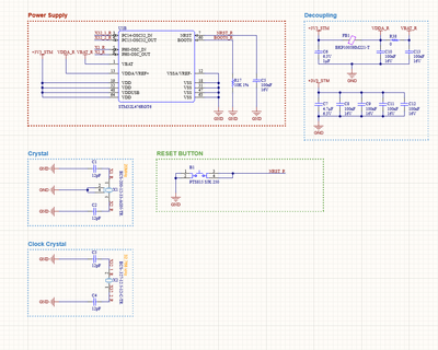

I am currently experiencing some weird reset behavior for my STM32L47 chip. Due to a non-optimal combination of HW the chip resets from time to time, and I am assuming an ESD issue being the reason for this. As long as the resets are recoverable, it does not really matter.
This is where the trouble arises: Some of the resets are not recoverable, and the chip get stuck in a weird state and will not power on correctly. We see that the watchdog triggers, but it does not enter its mainloop. If you spam the pin-reset it can in some cases reset correctly, but pressing it once does not get it out of this freezed state. So the easiest way to get out of this state is to cut the power and turn it on again. Checking the control status registers during resets we have found the following:
  • Some resets report pin- and IWWG-resets. This is fine and then the chip resets correctly.
  • When the reset reports pin-, IWWG- and Brownout-resets, it get stuck in the "freezed" state.
So the common denominator for resets that causes the chip to freeze is brownout. If this indicates an actual brownout, or simply a "bug" due to some strange ESD behavior I can't really tell. We have tried measuring during resets as well, but we have not found any obvious bugs in the HW. We have also simulated a brownout, but did not manage to get it into the freezed state.
We tried to increase the brownout level from 1.7 V (default) to 2.5 V, but this had no effect and we still experienced the "freezed" behavior.
Does anyone have any tips on what this freezed behavior can be caused by? Is there some obvious configuration to look into when experience these types of bugs? FYI: the chip are currently running RUST code.

waclawek.jan
Spurious bootloader (system-memory) entry? BOOT0 pin is wired how exactly?

waclawek.jan
> There are indication that the system is stuck at clock init
What indication? The usual thing to do when something like this is suspected is to toggle a pin around the suspected routine and observe on oscilloscope (or just watch if it's a LED).
What is the clock? How is it used? Is there any LSE clock/VBAT? You may perhaps want to post relevant portion of schematics.
ARed
Hi again ;)
Attaching clock configuration, can provide more info if needed. I also added the init of the periphs...
Added the schematics for the clock HSE and LSE, and power inputs.
We tested changing the IWDG timeout to random number eg. 6-10 sec. Then we observed the NRST changing accoringly but the system was still in a "Lockout" mode. Only a full power cycle would start it normally again.
Connecting a debugger unstucks the MCU.

waclawek.jan
What do you mean by "Lockout" mode? Is it repeated watchdog reset (i.e. NRST resetting periodically)?
Have you tried to spot the exact point where the problem occurs, e.g. by the "toggle a pin/LED around suspicious pieces of code" method? I don't Rust but the piece of code you've posted appears to be pretty high level, so if you are using some sort of library you should dig there too.
What you see may be also consequence of the VBAT brownout erratum. A simple way to check is to add an explicit backup-domain reset *before* any attempt to set up clocks - and as you don't have a backup battery, this should also remain there, too.
Hi there,
I'm a collegue of these two guys. So by "lockout mode" @ARed  means that STM enters an unknown state at which it doesn't do anything and it can not be reset either internally (watchdog) or externally by NRST pin pulling low.
However, at this state the internal watchdog triggers as if it tries to reset the STM, but the chip doesn't come back. Once in this state, STM will stay "stuck" until the battery is running-on, drains. The only way to reset it is to reset power (e.g. unplug battery).
What you mentioned about VBAT brownout erratum might be relevant here.  While monitoring some pins to try and capture something with an oscilloscope, we saw that when this occurred there was a dip in the STM power line, which is the same for VBAT. I add a picture here to show that better.
The scale here is 1V/div.
waclawek.jan
How do you know that? Can't it be running in its internal bootloader? Or stuck in some unhandled error, or in a loop during attempt to start up? Maybe using a debugger could reveal that.
Nonetheless, if the waveform you've shown is VBAT, regardless of whether it is connected to VDD/VDDA or both, if it goes below ground i.e. to negative as much as you've shown, that may be a concern too, and may have resulted in latchup; so you may want to eliminate that possibility first, by reviewing the power supply arrangement.
