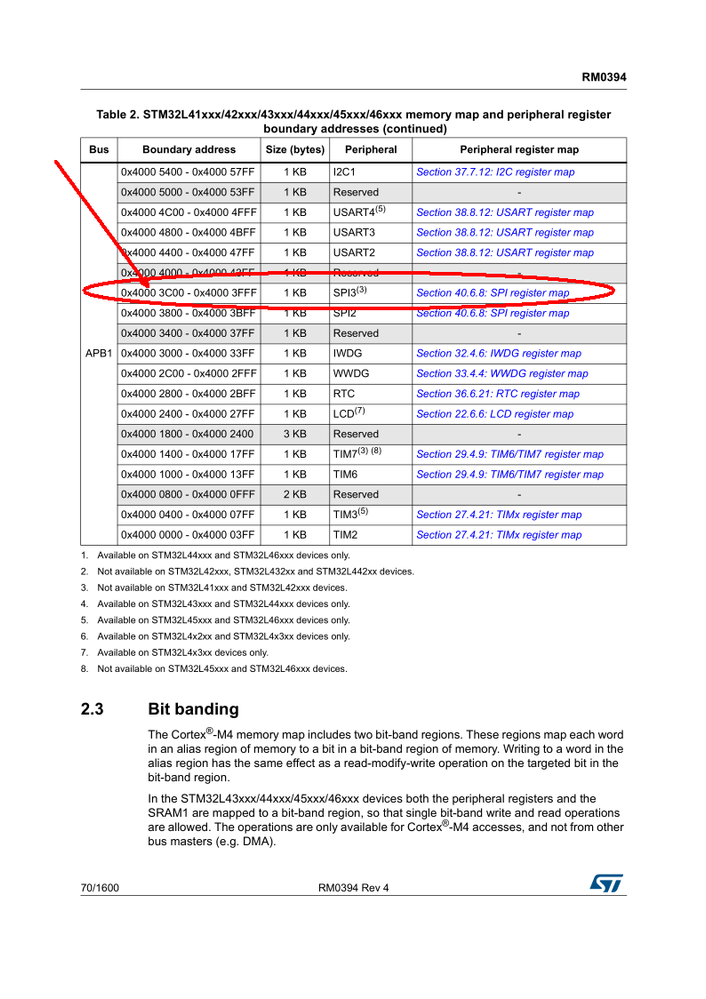

STM32L462 Can not start DMA transfer via SPI.

Read out and post SPI and DMA registers content.

This is the state of registers before I set the TXDMAEN bit, which should start the process.
And the DR is at offset 0x0C, i.e. SPI->DR is at 0x40003C0C.
MDrak.1
Yes I copied the register value incorrectly. Twice. In my code I had 0x40013c3c then I copied it to my list as 0x40013c03 and the correct value is 0x40003c0c.
I will test with that. Incorrect data register address should stop things from working. Thanks.
