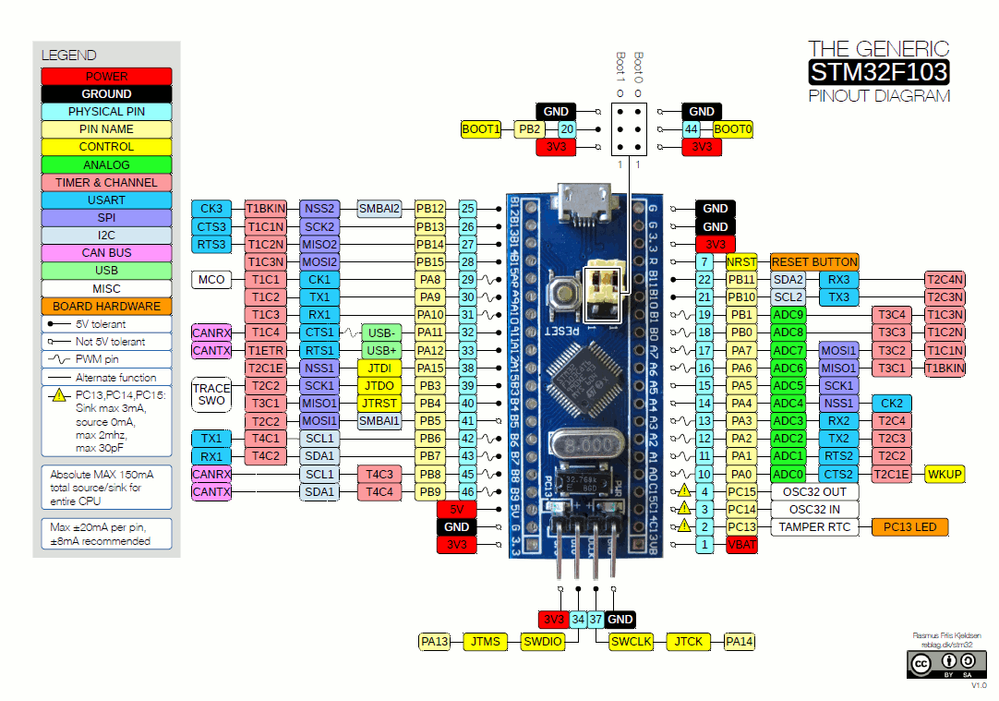

Curious detail on the huge spread "blue pill" boards :
the LED is on pin ..what is to be expected? PC13 !

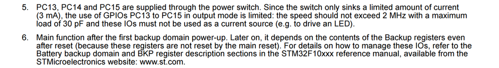

Not sure, if this Issue also applies to the STM32F103. On the first look I could not see any entry in the Errata sheet.
maybe....anyway PC13 use is...problematic :)
_legacyfs_online_stmicro_images_0693W00000bl72fQAA.pngfrom F103 ds .Table 5 .
The description in the errata of the STM32F407 is much clearer to me. I also notice, that the errata entry was only added in February 2023. So, I wonder what is with older designs out there...
In this respect, PC13 on 'F1xx is no different from PC13 on other STM32 (perhaps except 'L0) - they all are in the VBAT domain behind the current-limited switch, and their GPIO function is overriden by RTC.
