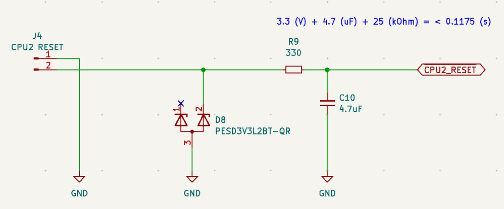

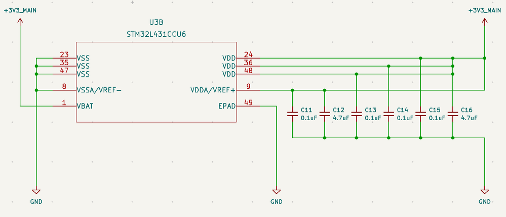

I want to read the BORRSTF value to detect the previous reset situation during the start process. but BORRSTF always reports '1'.
BORRSTF can be clear with RMVF, but there is a problem that makes it impossible to tell whether it is an initial start or a after brown out reset.
I tried the following:
  1. Check ramp-up time problem of power supply. - but I didn't find anything strange.
  2. Increase capacitance of the reset pin for the longer reset delay. - I've increased it from 0.1 uf to 4.7 uF, but problem is not solved.
I looked for similar cases, but I couldn't find the same one... Is there a problem with my design?
Attached power and reset circuit diagram I designed. thanks.

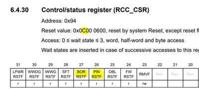

> this behavior is not documented anywhere, like RM0394 'Reference manual for STM32L4'.
It absolutely is in there. Reset value shown that BORRSTF is high on startup.
More to your point, looks like there isn't a reliable way on here to differentiate between POR and BOR. You could set a magic value in SRAM on startup and if during the next startup it's the magic value (instead of 0x00 or 0xFF or random data), likely it was a BOR.

Just a moment ago, I found the same BORRSTF issue on evaluation board known as 'Blackpill' (STM32F411). what I'm really curious about is, why is BORRSTF active on initial power up? this behavior is not documented anywhere, like RM0394 'Reference manual for STM32L4'.
0V is below the BOR threshold.
@TDKThank you for your answer.
Oops, I was making a false assumption that the initial value of the CSR register would of course be filled 0. thank you for your correction. :)
I agree with you regarding POR flags. fortunately, I think it can be solve through linker settings.
