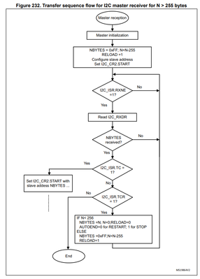

I am using STM32C031C6 for I2C verification.
I tried to communicate 2050 bytes of data using the HAL driver.
However, it did not receive the correct data.
To be precise, the data at 512,1024,1344,1346,1538,18561 and 1858 bytes were different.

Hello @kkazu ,
If you want to receive 2050 bytes of data, please flow this sequence : ( Figure 232. RM0490 )

Hi @KHALSI_Foued
Thank you for your quick response.
I used STM32CubeIDE 1.13.0 to create the template.
Checking the code generated by STM32CubeIDE 1.13.0, it seems to follow the flow you told me.
I've just started using the C language, so I may have overlooked it, so I'm attaching the generated code, so please check it.
