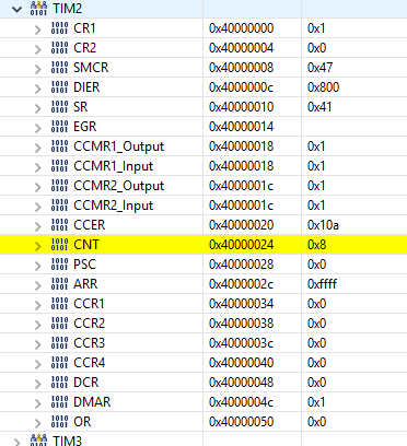

Post the content of TIM2 registers.
‎2019-10-11 4:31 AM
Here is the register capture from Atollic Studio:
‎2019-10-11 4:36 AM
looks OK
