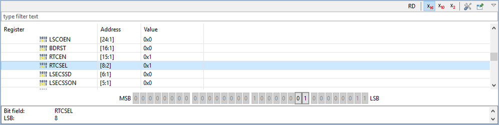

Check (read out) respective RCC register (RCC_BDCR.RTCSEL) whether you are clocking RTC from LSE indeed.

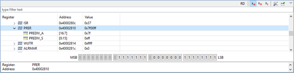

Check (read out) the RTC divider registers.
Checked:
Checked. According to this its fine:

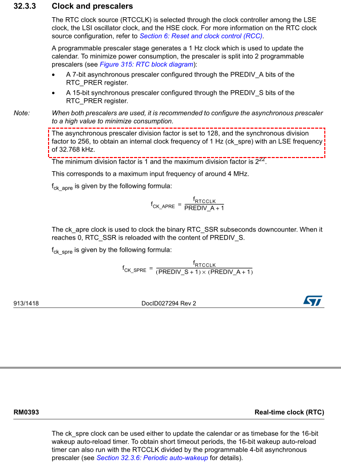

The red outlined portion could be confusing it defines PREDIV_A as 127 (128-1), and PREDIV_S as 255 (256-1), allowing the Fck_spre formula to be correct.
