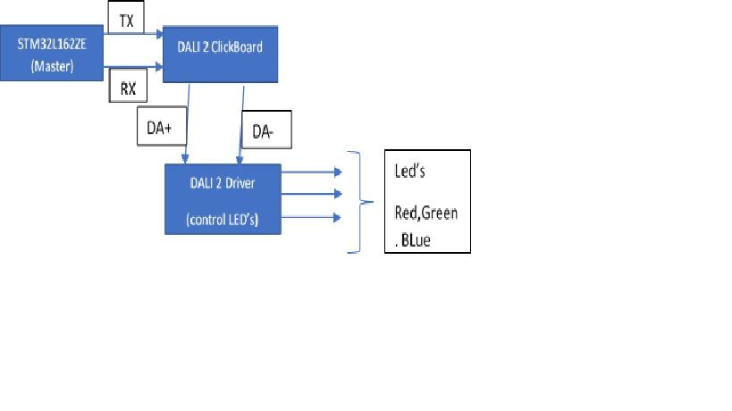

Hi Team, Planning to interface DALI interface to STM31L152- EVAL board kindly suggest me.
STM32L152 EVAL - Master
DALI 4 channel LED dimmer - slave
Dali click2 Board - Bridge
So, How can i use DALI stack library ....is that direct ST provided code can use...??? or any other tool (MiKroSDK /Mikro C pro for ARM) required...???
I found STM32L152 Slave library is STM cannot be used as master if it is then DALI library for STM how can be used....its not available with ST. could not abe find in STM site..???
please help me by providing example or any application note for How to implement DALI with STM31L152-EVAL as beginner....???

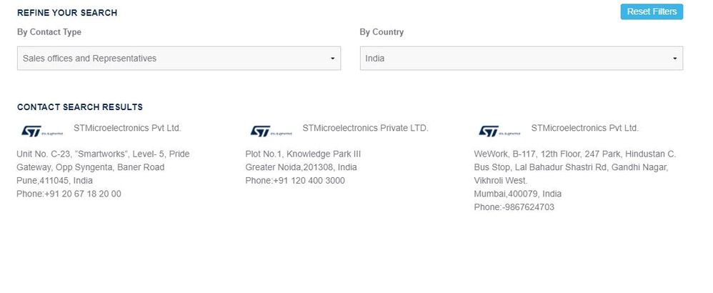

What I understood from your initial post, you need the source code of this library. In this case, you need to contact nearest sales office (as precised in UM1629, page 10).
You can select a contact depending on your location, or submit an online request here.

Thank you so much for your quick response. It helps me. I referred almost all the details given by you but i have a confusion let me explain my requirement.
i mentioned my req in previous post also .Please find the below image just for high level understanding
Kindly clarify me below points.
  • I am using STM32L162ZE using as a master and slave can be LED dimmer/DALI driver(as shown in image) but i found Slave_DALI library of STM32L152EVAL board from link provided by you in above post.
Do we have separate Master Library ...??? or Slave library only and its also just kind of application not Complete DALI library it seems is it right..???
  • We found the Libstock supported from Microelcetronika but for that we need to purchase MicroSDK IDE it does not suits for my requirement as i am using development in KEIL(MDK-ARM) already and here my basic question was
  • Does ST have all DALI Library Source code which works for my requirement(like master and slave complete DALI protocol) to develop my
application (like having HAL library) .....??? if available well and good i can go nearest office(as you provided link) and buy...please let me know technical contact.
  • If ST have Complete DALI library(DALI protocol)supports STM32L1xx we are planning to purchase and kindly provide the details.
  • meanwhile trying to contact sales team unfortunately no one picking call if any mailid please provide

SO what i understood that the master( STM32L162xx) looks complex and ST have only DALI slave Library...
As mentioned in application note page 10 (https://www.st.com/resource/en/user_manual/dm00082096-stm32l1xx-dali-slave-interface-stmicroelectronics.pdf) need to contact sales office to purchase the complete DALI stack library in that case if we can purchase that using that DALI stack can we implement our application ...???
STM32L162xx -> Master
LED driver -> slave
can we implement DALI protocol by using STM provided DALI Stack Library ...if we buy the complete source code of DALI stack library...???
Kindly reply to me so that i will proceed.
