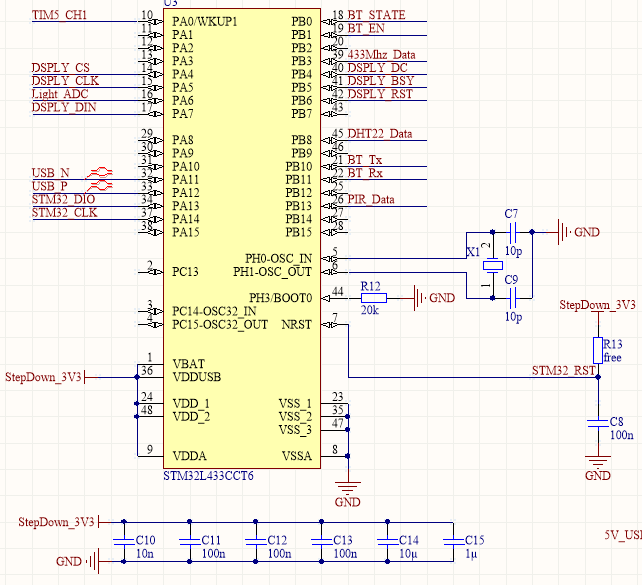

I have three custom pcbs. The heart of all pcbs is the STM32L151CCT6 µC in LQFP48 Package. I connected all supply pins (VLCD, VDDA, VDD_x to 3.3V; VSS_x to ground). The BOOT0 pin is connect to gnd with an 20k pull-down resistor. The reset pin (NRST) is connect with an 100nF capacitor to GND and an 10k pull-up resistor to 3.3V.

My schematic is attached. You can ignore the other GPIO Pins. I haven't connected them yet.

Do you really have no decoupling capacitor at VDD? Then expect any kind of strange behaviout. And those decoupling caps should connect VDD/VSS with short wires! nRST at the STM32 also has an internal pullup, R13 may be contraproductive. Remove it. C8 should also connect nRst to GND with short wires.

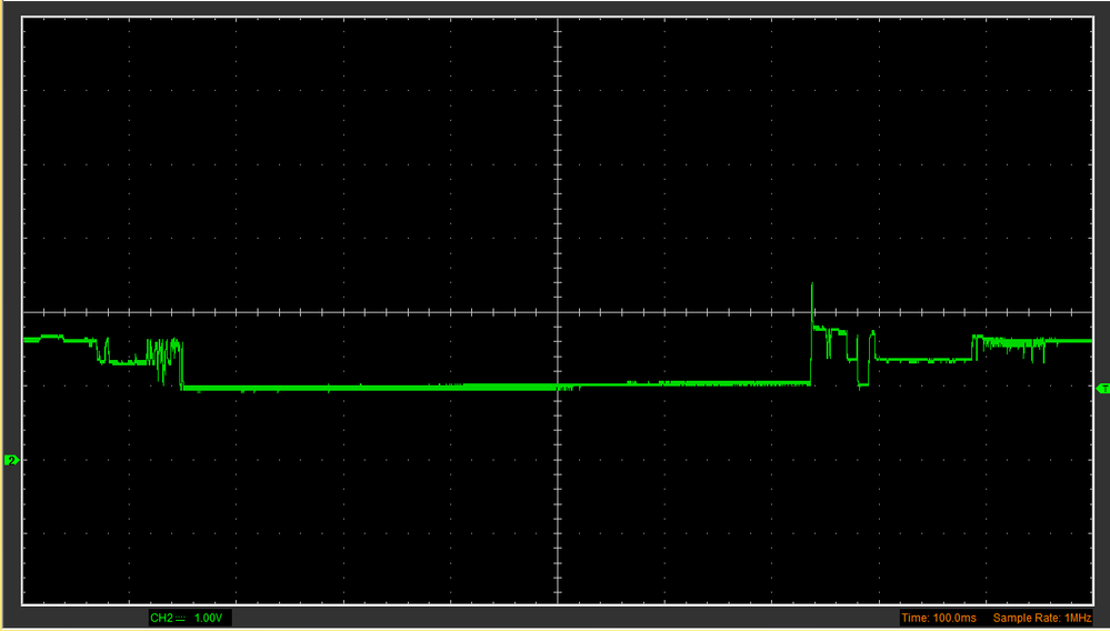

Observe the NRST pin using an oscilloscope.

C8 is near the reset pin.

Some dancing NRST signals are attached.

@Uwe Bonnes​ I now updated my circuit (took a couple of months because of education) with decoupling capacitors and I replaced the µC to get better Performance and everything is working fine! Thanks a lot.
Well, I study electronics at the moment so I didn't yet know much about decoupling and so on...
But now I am glad that it works.
Thanks to all who helped me! Here the circuit of the working µC (The capacitors are placed as close as possible to the µC):

as you can see in this thread, I had to place decoupling capacitors very close to the µC.
You can also have a look at Getting started with STM32L1xxx hardware development. Have a look at page 10. There is the power supply scheme with all decoupling capacitors needed.
