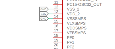

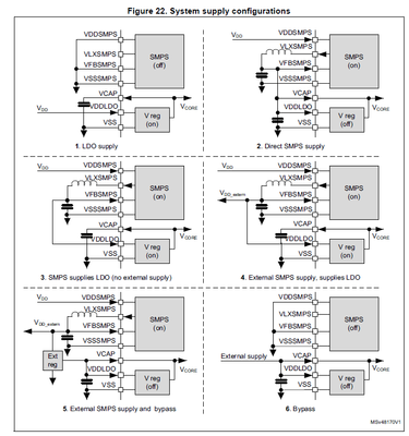

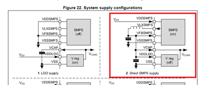

Hello @Hank_Schrader and welcome to the ST community,
You said:
@Hank_Schrader wrote:
- CubeMX power mode: PWR_DIRECT_SMPS_SUPPLY.
But according to your schematic, SMPS is almost not connected.
From the RM0399 / figure 22, this is the hardware configuration for the direct SMPS:
The question is, how did you design your board? did you refer to any reference design?
NUCLEO-H755 board schematics for example?
The following are the different HW power config listed in the reference manual. Did you refer to the documentations: reference manual, the datasheet or the AN4938 before starting your design?:

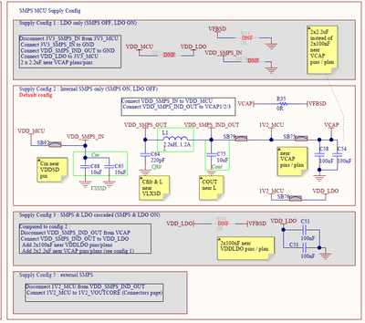

2025-11-14 4:03 AM - edited 2025-11-14 4:04 AM
I think you are mixing between the function of your 3.3V LDO regulator and the External SMPS function.
So you have an external 3.3V LDO to be connected to VDD of the MCU, right?
So use LDO mode instead (the LDO internal to the chip), and refer to one of the design reference:
Look at the NUCLEO-H745 schematic and inspire from. It proposes many power config:
Hard to explain all the stuff here. You need to refer to the reference design.
