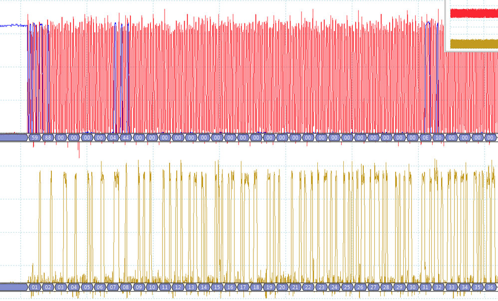

Hello, in my setup the STM32L151CBT6 (32MHz) is configured as slave of a PLD Master, which provides a 4MHz Clk for the SPI communication.
After a short "handshake" between slave and PLD where the slave sends and receives some bytes (with HAL_SPI_Transmit and HAL_SPI_Receive in a while loop until a specific handshake value is received) for confirmation that it had a successfull "start-up" phase the master then starts sending 64Byte Data packages in a cyclic manner.
In previous tests I (with the help of the forum Einstein TDK) came to the conclusion that the HAL_SPI_TransmitReceive function is to slow. So now I want to use the HAL_SPI_TransmitReceive_DMA function. When I just use the HAL_SPI_TransmitReceive_DMA function in a while loop in my main function I see (on a digital oscilloscope) that my master and slave send the right Dummy values in correct order.
My slave should have a 400µs window between each received package to manipulate data.
To test if my slave receives the right data during the operational phase I wanted it to copy the received data and send it out in the next package cycle.
I think the problem lies in the lack of understanding how to use the HAL_SPI_TransmitReceive_DMA function properly. Maybe someone can explain how I get my test setup working and how to use the HAL_SPI_TransmitReceive_DMA function the right way (and even if I can use it for my use case)?
I posted the simple main while loop for my Test setup, which does not work. It aborts the slave sending part afer the 1st byte.
  while (1)
   HAL_SPI_TransmitReceive_DMA(&hspi1, Configuration_Values_Tx, Configuration_Values_Rsx, 64);
   for (iter_i =0; iter_i < sizeof(Configuration_Values_Rsx); iter_i ++)
      Configuration_Values_Tx[iter_i] = Configuration_Values_Rsx[iter_i];

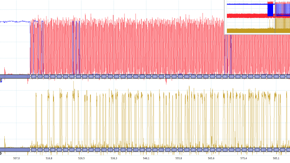

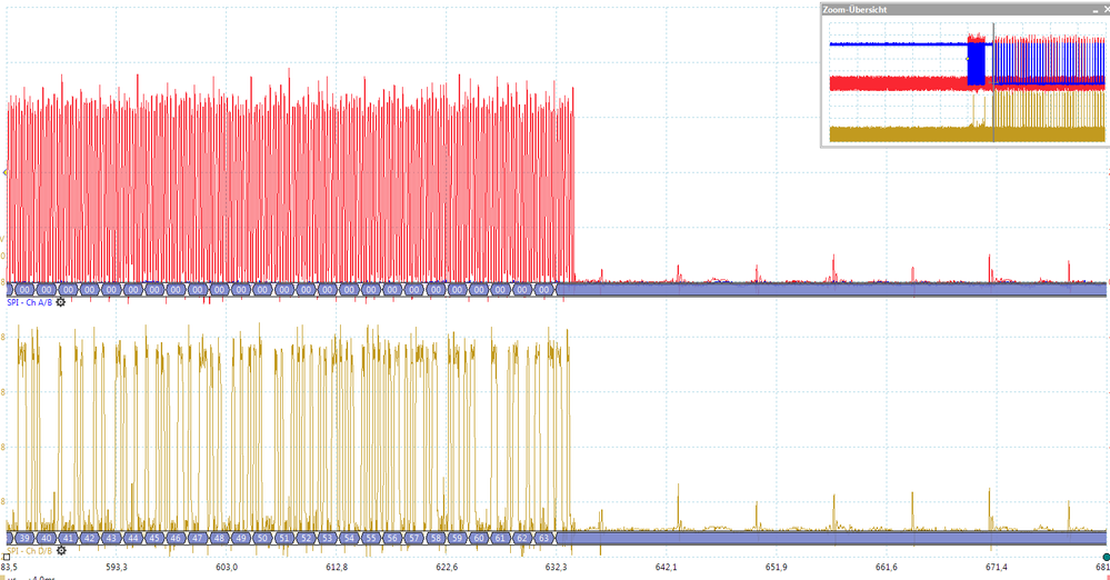

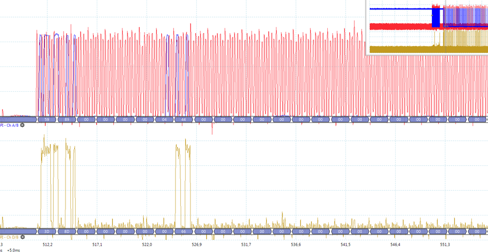

Chrizzly
Thank you guys for your answers.
I think I understand the basics of DMA and what it is used for. I think I am struggeling to understand how to use it properly so there is no conflict of accessing Data.
Unfortunatly the HAL_SPI_TransmitReceive function is to slow (see the description of my problem).
With the code below and two problems occured:

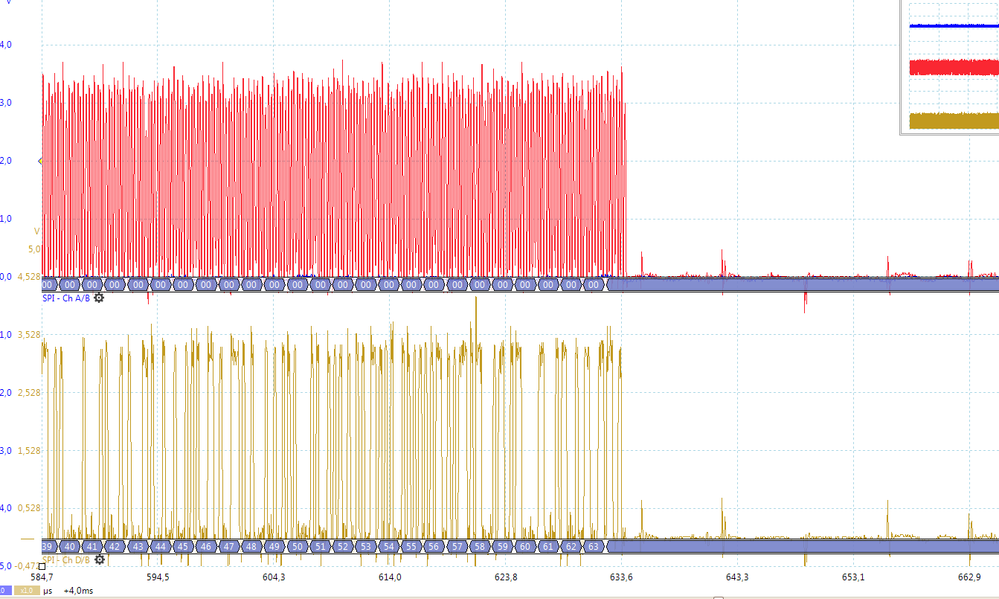

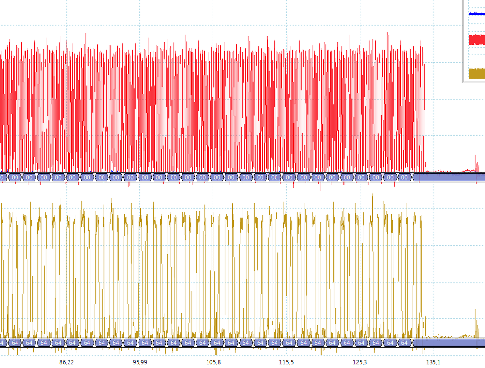

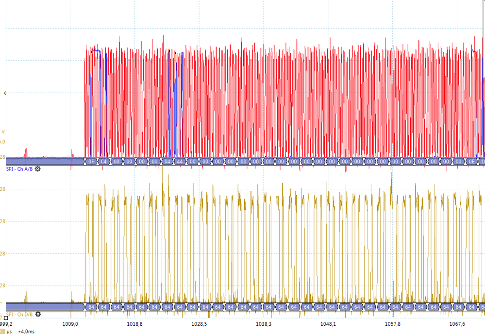

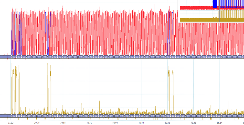

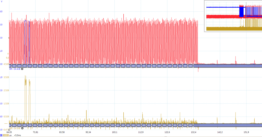

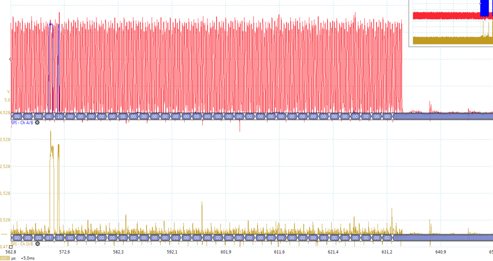

  • Data is not received properly / corrupted by my software (See attached Files Package_1 to Package_3)
  • After the 1st Package the transmission gets stuck at 64 (See attached Files 64_Problem)
Either one of the scenarios happen whenever I trigger the communication.
0693W00000GY2sbQAD.png0693W00000GY2rsQAD.png0693W00000GY2rJQAT.png0693W00000GY2rEQAT.png
