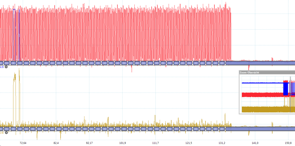

In previous tests I (with the help of the forum Einstein TDK) came to the conclusion that the HAL_SPI_TransmitReceive function is to slow. So now I want to use the HAL_SPI_TransmitReceive_DMA function. When I just use the HAL_SPI_TransmitReceive_DMA function in a while loop in my main function I see (on a digital oscilloscope) that my master and slave send the right Dummy values in correct order.

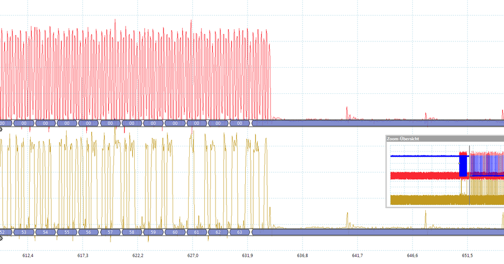

After the transmission of the initial package with the numbered bytes array (Configuration_Values_Tx[64] = {1, 2, ..., 64 }) was sent the following 64Byte packages had a value of "64" for each byte (like the "64_Problem_Package_2_01" screenshot).

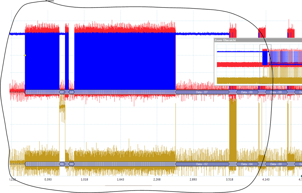

Maybe your trouble is not synced start. When you call
HAL_SPI_TransmitReceive_DMA(&hspi1, Configuration_Values_Tx, Configuration_Values_Rsx, 64);
your link on SPI need be without trafic. But when Master sends your data will bad and not sync...
You need add some waiting for pause.
Better is when Slave send requst IRQ to master and this start send based on it.
And from your images isnt clean Data is valid on rising or failing clock edge ? Is SPI set to this?

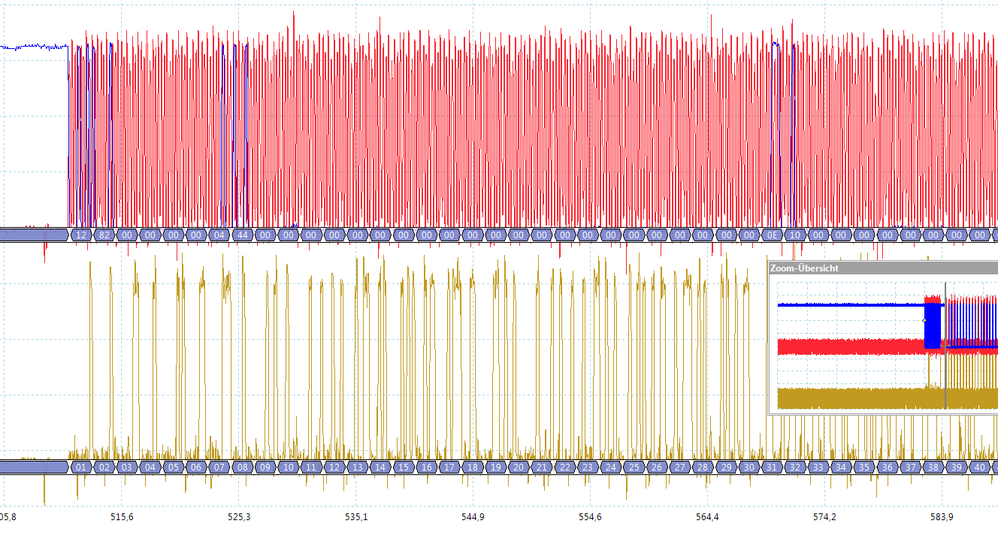

I didn't realize my clock phase was wrong. I changed it to second edge.
I configured DMA to circular.
After the configuration process the slave responds with a 0x02 indicating that it is ready.

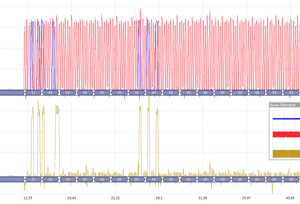

  1. The 1st Package is my initial dummy 64 Byte Array
  2. The 2nd Package should be the received data from the 1st transmission, but the 1st byte of the seconde package is always 01.
  3. The 3rd Package and the following Packages are correct.
The 01 could be from the 1st package where the dummy values are sent, but why? The 3rd and following packages don't show this behavior?
