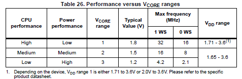

Either the core voltage or the flash wait state should be increased before setting HSI as the clock source.
Start reading at the Dynamic voltage scaling management chapter of the reference manual.

Thanks a lot! I knew I had to verify Vdd and the wait states, but to be honest I was lazy to do that. However my excuse is that the MCU runs at 16 MHz and Vdd is 3.5V when debugging. Despite that your comment is pretty important to be kept on mind.
