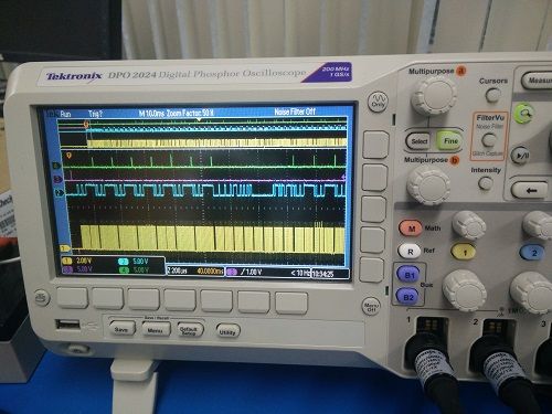

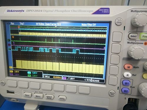

Anyway - for general viewing pleasure, here's a picture of what's happening.. Top picture is the good working operation on a debugger launch.. bottom is any other kind of launch...
yellow = CLK, green = nSEL, blue = MOSI, purple = SHutDowN signal...
So it's not so much the spi config that's mangled but the actual data and order of what is happening?? really weird.
What's also funny is the programming code actually claims that either of these things have programmed the chip successfully...
