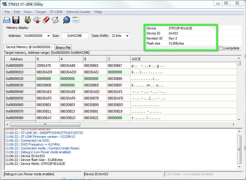

Posted on May 24, 2017 at 05:12
you can also use the STLink utility.
After connecting you see the device ID and dice revision on the main screen.

Posted on May 25, 2017 at 11:26
Hi Max and Clive One,
Here is the ID
0690X00000603r2QAA.jpg got from ST_Link.
