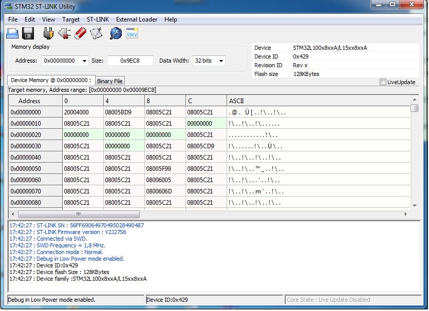

We have a custom designed STM32L151R board. We have not been able to flash the code using the flash loader application (demonstrator gui) . We are able to load the code using ST-Link and the serial port works properly when configured through the code. Is this an inherent problem of the controller or are we doing something wrong? We need to get the serial boot loader working as there may be site updates. Thank you for your time. Awaiting your suggestions to solve the problem.

Could you pleasecheck with STLINK-Utility @address 0x00000000 if boot is configured to system memory where bootloader resides or not ?

Posted on May 29, 2017 at 14:30
Hi Imen D,
Hope this will help.
Posted on May 29, 2017 at 14:34
Hello Clive One,
Checked the Rx and Tx pins with an oscilloscope. Pulses are seen on Rx pin of the controller whenever 0x7F is sent from PC/Laptop, but there is nothing on the Tx pin. Thank you.
