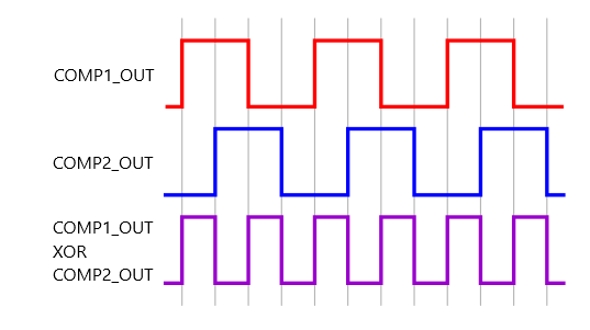

I have a STM32L072KB microcontroller and want to combine two analog signals (they represent a kind of "quadrature encoded signal" with a 50% duty cycle) into one "combined digital output signal", which have the doubled frequency (for my purpose the doubled output signal is used to provide the doubled accuracy)

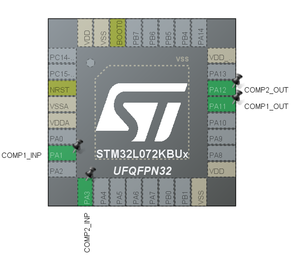

I am using the both comparator peripherals COMP1 and COMP2 for detecting the signal edges and it works fine to configure them that they directly relay the COMPX_OUTs to a predefined, but for each comparator separate and fixed GPIO (without any SW/ISR delay):
- COMP1_OUT -> PA11
- COMP2_OUT -> PA12
Due to my HW layout, I want to realize something like this configuration:
- COMP1_OUT ⊕ COMP2_OUT -> PA11
or
- COMP1_OUT ⊕ COMP2_OUT -> PA12
I have not found a way to directly connect both comparator outputs into one single output pin without introducing an SW/ISR delay/latency. I read that some general purpose timers offer a so called "Hall" encoder mode, which supports XOR-ing up to 3 input signals. But since connecting a Timer directly to a GPIO via DMA seems to be impossible on a STM32L0-core, I have no idea how to implement this...
Does anyone know a "hardware/fast way" to route/XOR simultaneously both COMP_OUTs of a STM32L0x2 to a single GPIO output pin (either PA11 or PA12) or is it in that case inevitable, to use an ISR-based solution (the HW-layout is fixed and cannot be changed)?
