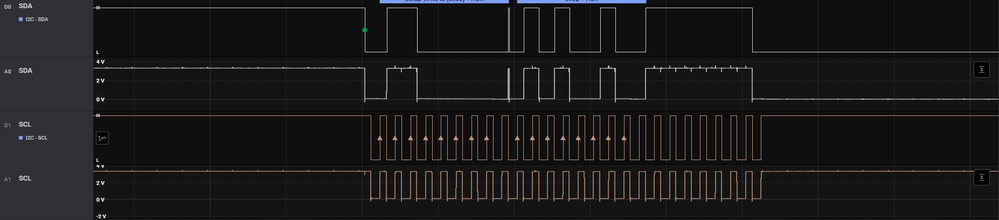

I have an STM32L073 communicating with an IS31FL3246 LED driver over I2C. Occasionally the MCU will not send the 9th clock pulse and therefore locks the bus. 0693W00000NqEtpQAF.png(As shown in the picture the analog signal has a valid waveform without much noise)

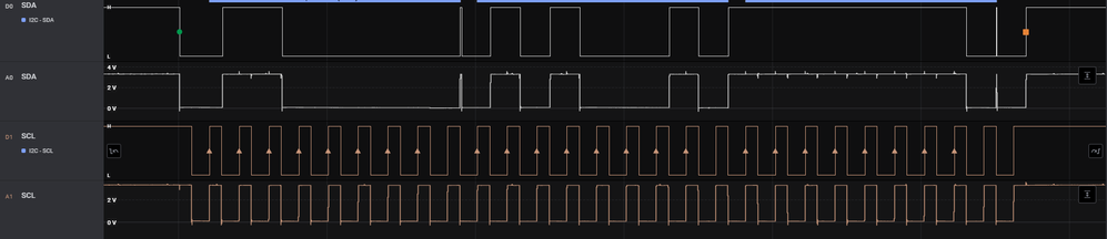

Before this happens there are several valid I2C transactions like this one.

On the faulty capture, it looks that slave ack is missing...
Yes, that is because it doesn't get a clock pulse from the master where it can send the ack. The issue is that the 9th clock pulse is missing...

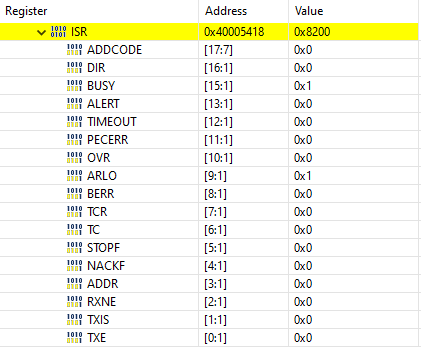

> Last point, when the issue occurs, could you please read the I2C_ISR register to get the status of the I2C peripheral ?
0693W00000Nqv6vQAB.pngThe ARLO bit is set but there are only two devices on the bus, the master (STM32L073) and the slave (IS31FL3246).

Apparently you have to handle ARLO even if there's no other explicit master on the bus, as glitches/slow edges may make the slave to think that there's other master pulling down SDA.
The older I2C version (in 'F2/'F4 and older) tends to stop clocking and lock up amidst a byte, when this happens, without setting the arbitration lost bit, so timeouts are vital there.
Decreasing the pullup value and reviewing grounds/crosstalks decrease likelyhood that this happens. Tinkering with the analog/digital filters, and maybe with relevant GPIOx_OSPEEDR, may help too.
Hi Jan,
At the moment I have a workaround which detects timeout, and therefore also ARLO. When that happens I pull the reset pin on the slave and restart the communication. I was hoping there was a better alternative but as I understand it from your answer this is expected behavior and therefore that is the "only" fix?

Gustaf,
What I try to do is, get things working without any of these fixes (see above my remarks on grounds (LEDs, they suck high current in pulses, heh?)/crosstalks, pullups, filters), and then I put the fixes back for better sleep.
That makes sense, I've seen that there are filters in the microcontroller that I can activate but I haven't looked into it too much, maybe I should give that a try. I also at the moment have a crude setup with fairly long wires for development purposes, but when I get our first prototype boards we will likely have better signals and this issue will be less frequent. Your "solution" sounds like a reasonable way forward, thank you :grinning_face:
