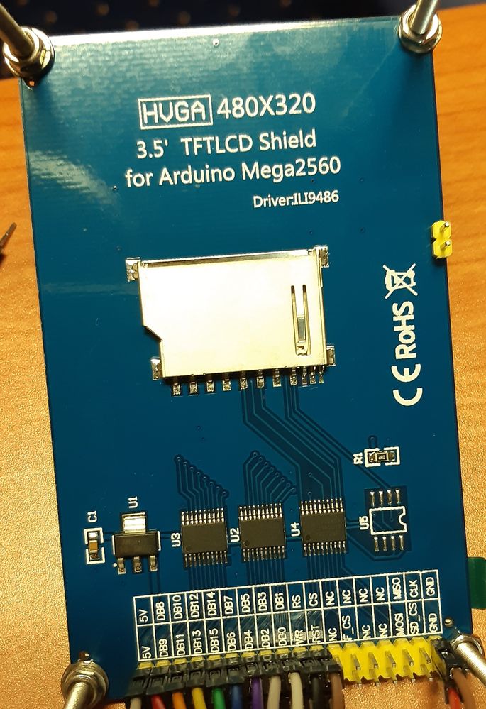

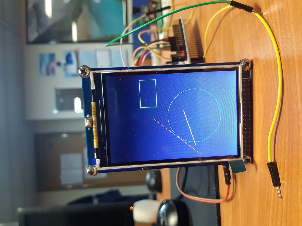

Couple days ago, I tried to interface STM32F030R8T6 dev. board with TFT display like on the picture with ILI9486 driver.
0693W00000HoSrkQAF.jpg0693W00000HoSsiQAF.jpgOne year ago, I interfaced the same TFT with FPGA de board and everything was fine.
With STM32 I tried to interface in 16-bit mode.
This display doesn't has the RDX pin for reading from it. Only Write Operations.

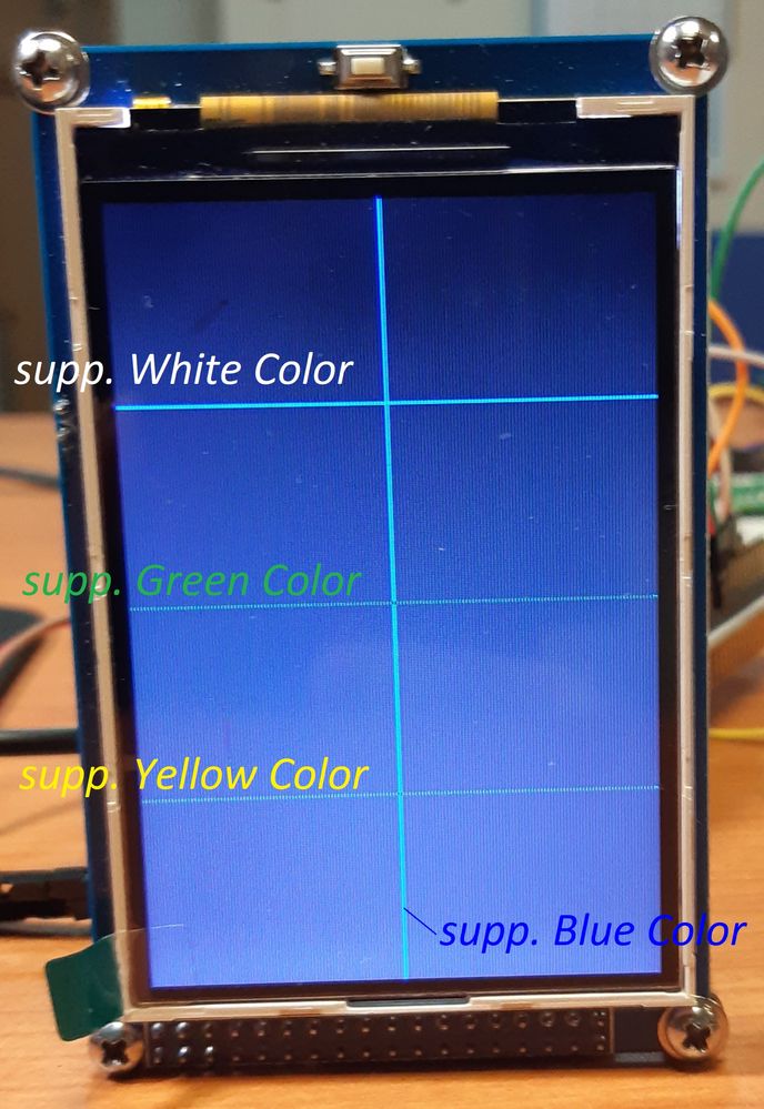

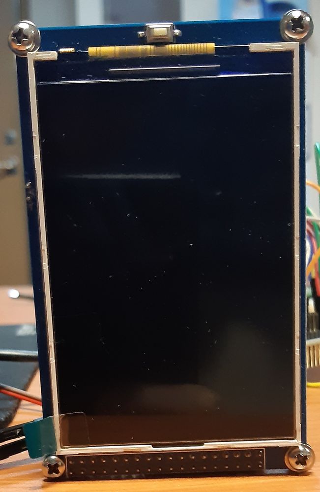

Problem is with colors.
When I set Red Backcolor, the display is shows it as almost Black color.
Green Color it shows as dark Green and Blue Color it shows correct.
So all colors which are close to red, slowly become darker.

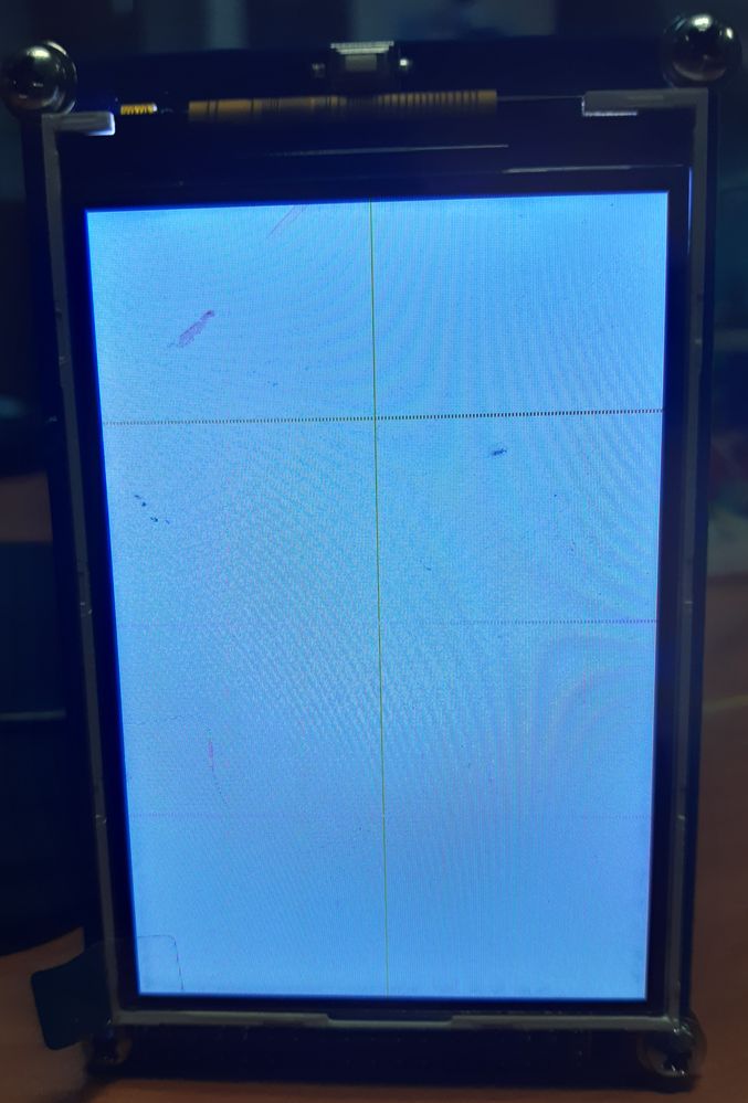

0693W00000HoSuZQAV.jpgI've tried to do Display Inversion mode Command, but it turned everything to Brighter color.
The Blue Color it turned to yellow, Green and Yellow turned to Purple Color, White Color turned to Orange.
0693W00000HoSvXQAV.jpgI understand, I did something wrong, but cannot find where.
