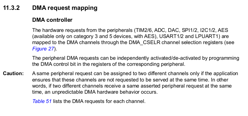

I've been trying to get simultaneous RX and TX working on USART2 of a STM32L073 and have not been able to get it to work. I've messed around with priorities, order of enabling DMA transfers, etc but always the TX DMA transfer succeedes and the Rx DMA transfer fails.
Looking through the reference manual it suggests to me that perhaps this isn't possible on this device as it states that two DMA transfers cannot have the same request number. When using DMA RX and TX on the same channel with this device unfortunately it appears that the same request number is required.
Does anyone know if it is possible to do simultaneous RX and TX on the STM32L073?

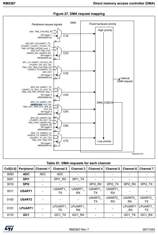

Pretty sure the hardware is capable of this and more, and the RX and TX will be on different channels. Going to pull the RM now
So yes enough channels to do RX+TX on USART1, USART2 and LPUART1 **CONCURRENTLY**
Transfer speeds orders of magnitude slower than the Bus and DMA are capable of, so priority is a complete non-issue.
I expected the same as it seems like a pretty basic thing to do. The reason I think it might not be possible is the paragraph above that page:
Where is states that two different channels cannot have the same request, in this case #4. This seems rather strange to me as having Tx and Rx on the same channel would be something I'd expect to be able to do.

The TX request is different than the RX request. The Caution note is saying you can't map, for example, USART2_RX to two channels simultaneously.

Right, but I think that caution is that USART1_TX can't be serviced by Channel 2 and Channel 4 at the same time.
The logic in the IC can't prevent you from doing that, as the channel's MUX is independent, and both will try to service the request, with unpredictable hilarity ensuing.
But USART1_TX_DMAREQ and USART1_RX_DMAREQ are TWO entirely different signal sources, derived from the TXE and RXNE status out of the units. They might share a common index number for the individual muxes, ie USART1 source, but the associativity is fixed and to different independent sources.
